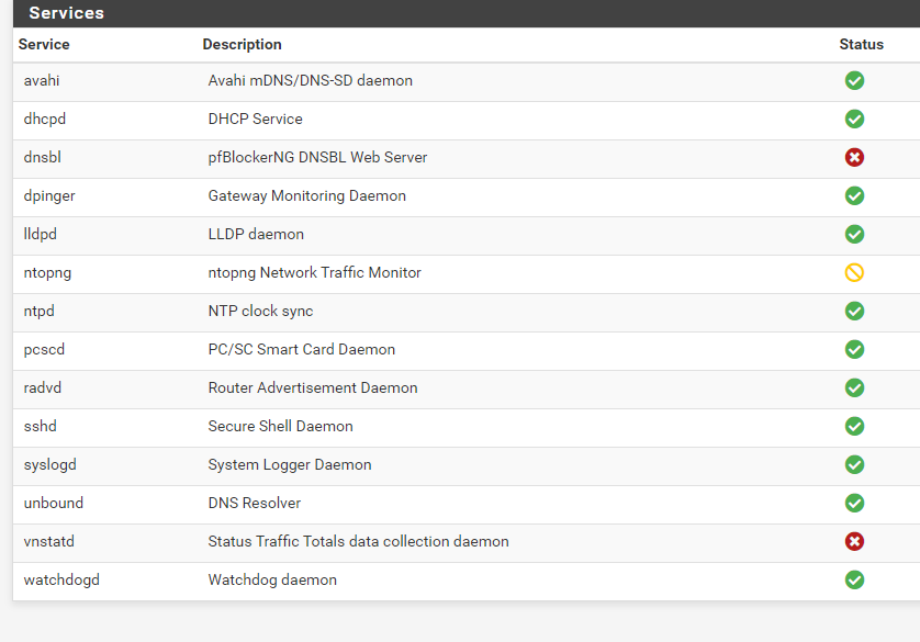

      Services tab, snort is nowhere to be found
      is this expected?

                @alpharulez there is also a swap issue on this release, my SG3100 started complaining about SWAP running out and stopped all processes very random and weird.....that was the last straw.....i downgraded back to 2.4.5-p1
