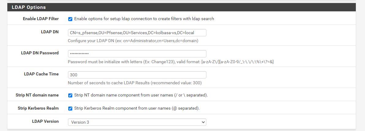

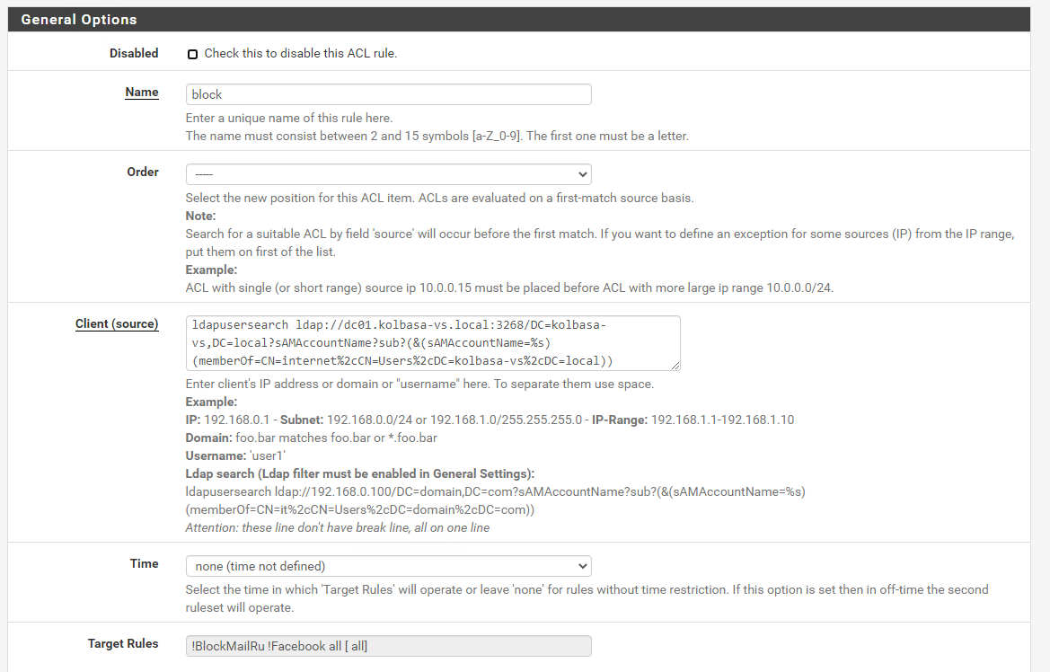

      I have a problem with squidGuard Groups ACL configuration. I'm trying to do ldapusersearch in Client (source) field of group "block", but looks like it doesn't work for me.

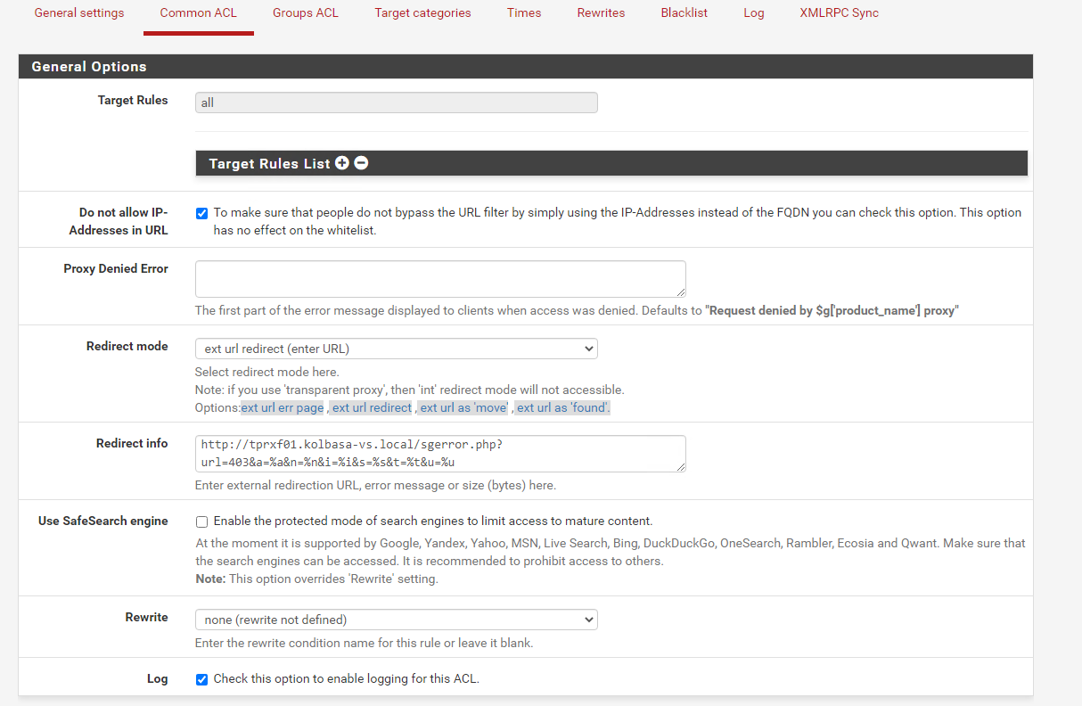

      Common ACL rules are working fine.

      LDAP query string used:
      ldapusersearch ldap://dc01.kolbasa-vs.local:3268/DC=kolbasa-vs,DC=local?sAMAccountName?sub?(&(sAMAccountName=%s)(memberOf=CN=internet%2cCN=Users%2cDC=kolbasa-vs%2cDC=local))
      Totally don't know where to dig, looks like squidGuard even not trying to execute ldapusersearch query cause after hitting this green Apply button I see only emptiness in this src block:
      src block {
      log block.log
      Need some advices.
      Thanks.

          Found some interesting thing. My settings and ldap string exists in /usr/local/etc/squidGuard/squidguard_conf.xml

                  <ldapbinddn><![CDATA[CN=s_pfsense,OU=Pfsense,OU=Services,DC=kolbasa-vs,DC=local]]></ldapbinddn>
                  <ldapbindpass><![CDATA[********]]></ldapbindpass>
                  <ldapcachetime>300</ldapcachetime>
                  <ldapversion>3</ldapversion>
                  <stripntdomain>on</stripntdomain>
                  <striprealm>on</striprealm>

          But for some reason these settings are missed in /usr/local/etc/squidGuard/squidGuard.conf
          Btw, I tried to manually edit /usr/local/etc/squidGuard/squidGuard.conf and add missed source string, then restarted squidGuard from WebGUI and it filtering for AD group works just fine.
          So, is it a WebGUI bug or something else?

            I can see it in my /usr/local/etc/squidGuard/squidGuard.conf:
            logdir /var/squidGuard/log
            dbhome /var/db/squidGuard
            ldapbinddn CN=s_pfsense,OU=Pfsense,OU=Services,DC=kolbasa-vs,DC=local
            ldapbindpass 123
            ldapcachetime 0
            ldapprotover 3
            src testacl {
                    ldapusersearch ldap://dc01.kolbasa-vs.local:3268/dc=kolbasa-vs,dc=local?userPrincipalName?sub?(&amp;(userPrincipalName=%s)(memberOf=CN=internet%2cCN=Users%2cDC=kolbasa-vs%2cDC=local))
                    log block.log
            Please update SquidGuard pkg to the latest version
            see https://redmine.pfsense.org/issues/11434
