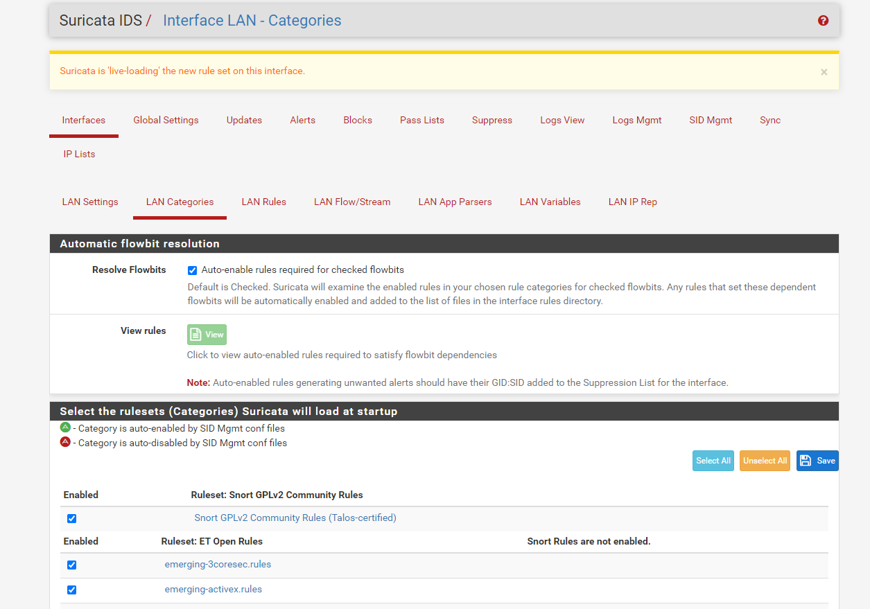

            What is your experience level with an IDS? Have you used Snort and Suricata in the past? Have you gone to the CATEGORIES tab for your interfaces and selected the rules categories there and saved the changes? Your screenshot of the ALERTS tab indicates you are only using the default built-in rules.

              And yes, I went to "LAN Categories" and selected all rules and saved.
              Then get the message "Suricata is 'live-loading' the new rule set on this interface."

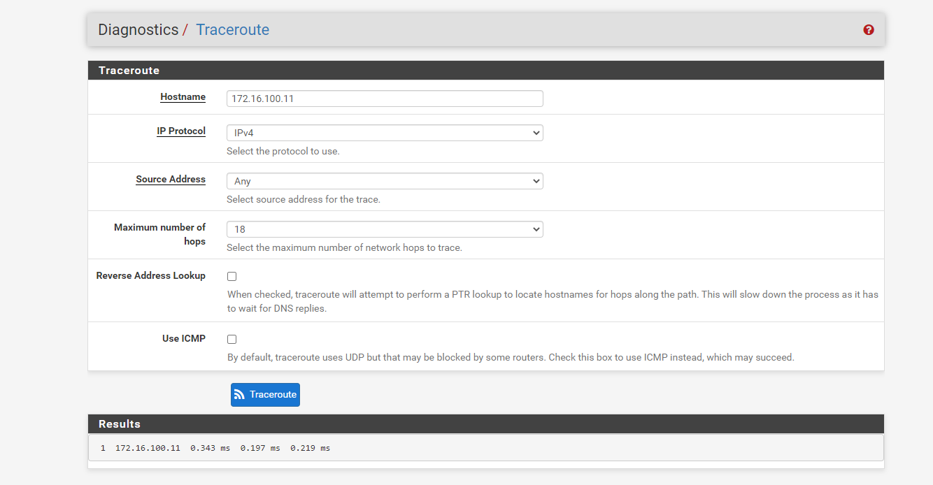

              I found in "Diagnostics"-Tab that it is only 1 hop to the Metasploitable VM and also 1 hop to kali, which makes me confident both VMs are connected to pfsense.

                Running tracert from your firewall itself does not mean much. It is not telling you how the Kali Linux VM, for example, is reaching the hosts you are scanning.
                You would want to run the tracert from the Kali Linux machine and see if the traffic is going "through" pfSense to reach the other hosts.

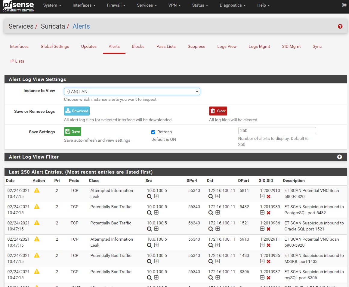

                Then see if you have alerts in Suricata for scans against VNC ports and perhaps SQL Server and others from the Kali host to the host at 172.16.100.11.

                  I do get alerts!!! :)
