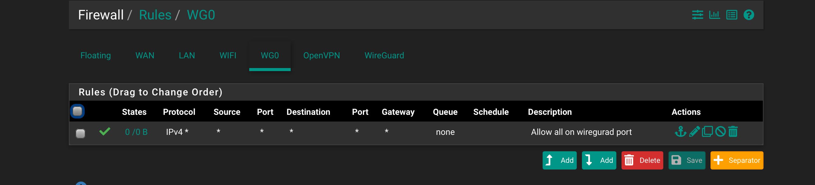

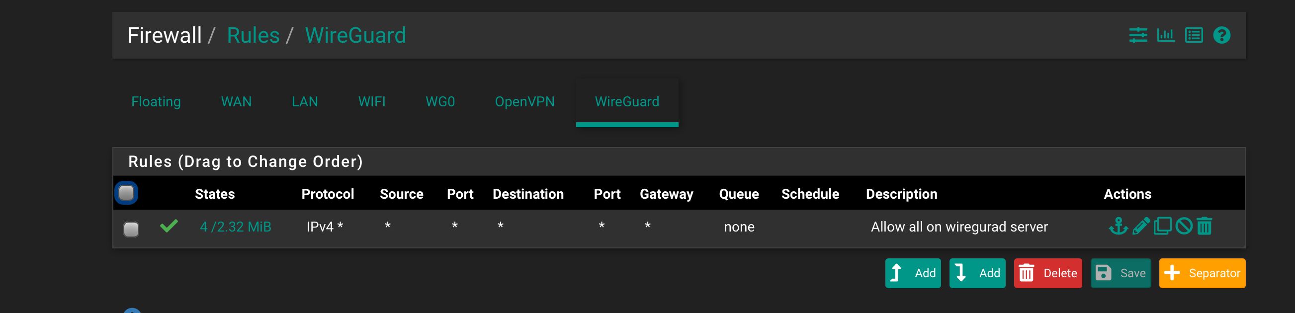

          • Is there a firewall rule on pfSense to allow the traffic in your wg interface and out your internet connection?
          Here is what I have in rules see attached
          Some boxes still not ping-able, need to test more
          Thx !
