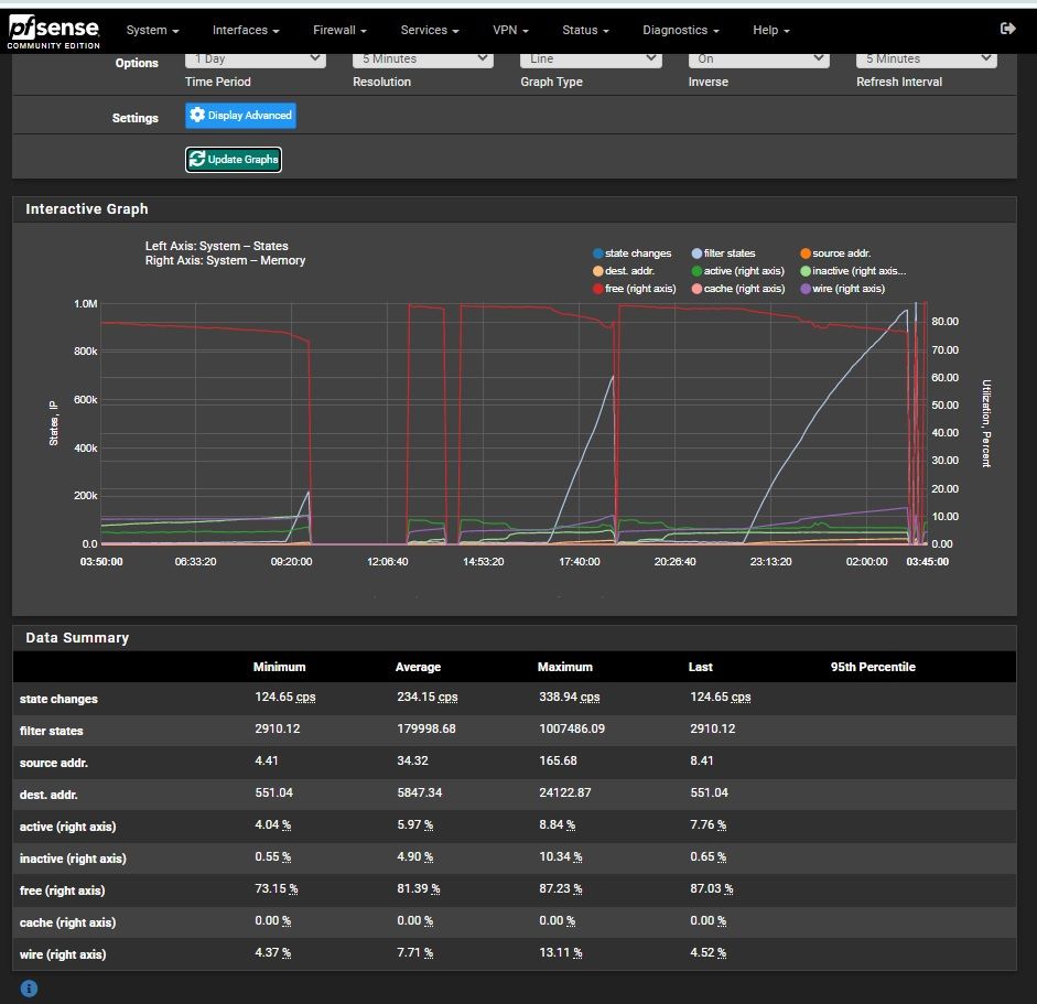

    Filter States keeps on Increasing and after reaching limit, internet connection is lost. Needs resetting states or reboot.
      Hi everyone! really have this issue even before the 2.5.0 update on pfsense.
      Filter states as per status/monitoring, keeps increasing even during low traffic period of the day. And when the number of filter states, reach 1M +, internet connection breaks and accessibility to webgui stops.
      I really tried looking for the solution, but to no avail. Hope to have some help from everyone.

            @hieroglyph sadly, filter states/states accumulate to 1M states at times. Meanwhile, no device in the firewall is creating 1M states. Not resolved yet...

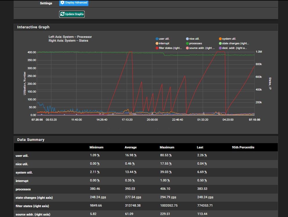

              oilahkestrada @oilahkestrada
