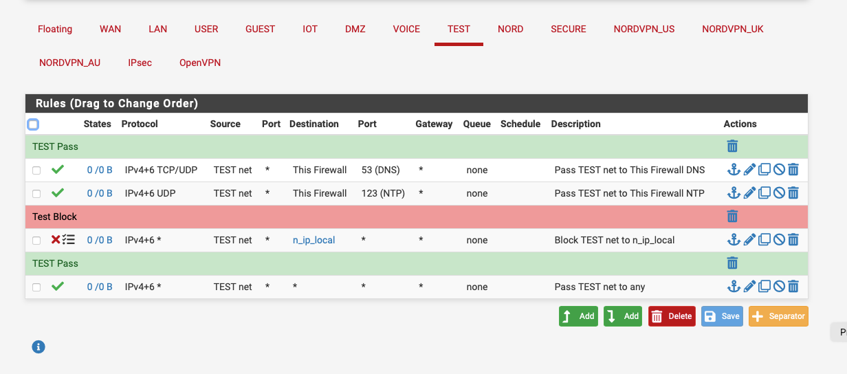

              Here's what I do:-
              n_ip_local contains all my local subnets, and I have internet access only from this subnet.
              Andy

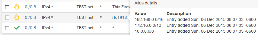

                You could be specific - or you could for say just create a rfc1918 alias.. Since it would be assumed that your other vlan/networks would be using rfc1918 space. So if you want an alias that blocks all access to any local network/vlan you might have now, or in the future you could just create a alias that includes all the rfc1918 space
                When wanting to block stuff - the this firewall is a good built in alias to use, because it would also include your wan IP.. Which is normally if your blocking a vlan from going to your local stuff - you prob want to block it from access pfsense gui via the wan IP..

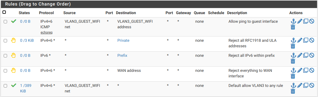

                          It sounds like you're setting up a guest WiFi. Here are my rules for mine:
                          Private and prefix are aliases.
                          UniFi AC-Lite access point
