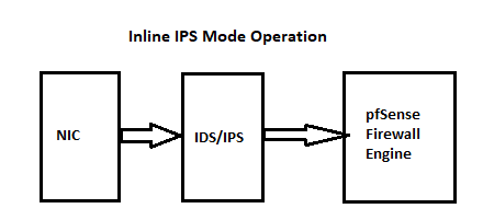

        In Legacy Blocking Mode, Snort is analyzing copies of packets that traverse the interface. The PCAP library is used to make a copy of every transiting packet, and Snort inspects the copy. But the original packet has continued on to the firewall engine. So that packet is the "leakage". Once Snort determines a packet or stream needs blocking, it will make a FreeBSD system call and insert the IP address from the alerting packet or stream into the pf firewall engine's snort2c table. That's a table created internally by pfSense at bootup. Any IP placed in that table is blocked by the firewall. If you select the "Kill States" option when configuring blocking, Snort will also kill all states associated with that IP when it puts in the snort2c table.
        Inline IPS Mode is diffferent. In that mode, Snort uses the netmap kernel device in FreeBSD to create a pipeline between the physical NIC and the kernel networking stack. Packets then must go through Snort to get to the kernel (from the NIC) or to get to the NIC (from the kernel). See the diagrams below. Note that not all NICs support Inline IPS Operation due to its dependency on the netmap kernel device. Also, things like PPPoE and LAGG and other virtual type interfaces don't work properly with Inline IPS Mode.
