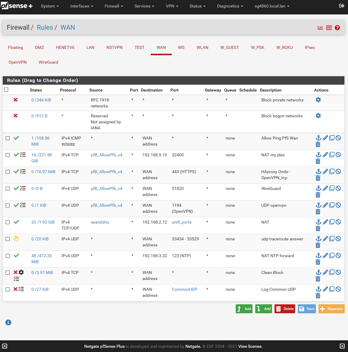

              Could you post up this rule please... For example here is mine..
              Notice I icmp allowed there on the top.. have never seen anything that couldn't ping my wan..

                    Here is the top of my current WAN rules:

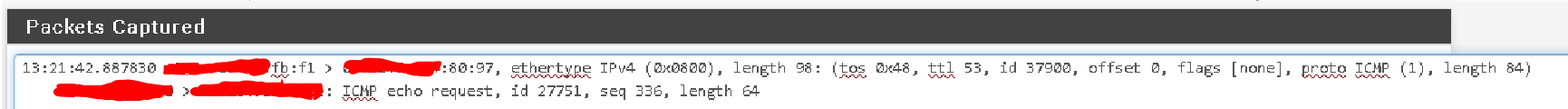

                        Here is a packet capture from the same approximate time:
