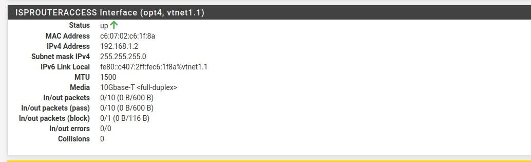

        Now, the only issue is that I can still not access the ISPRouter from behind the pfSense Router. It is not the biggest deal, since I do not need to touch it anymore and I can access it by connecting a ethernet cable to it directly from the laptop, but I would like to have access from the pfSense LAN network. I think I followed @dma_pf advice but still not connecting. Here is the relevant configuration (feel free to ask for anything):
        I created the VLAN interface and gave it a static address in the range of the ISPRouter address:

          You don't have to set up a new gateway. But you do need to let the new ISPROUTERACCESS interface route out of pfsense to get to the router. Move this rule to the ISPROUTERACCESS tab in Firewall/Rules and change "LAN net" to "ANY" :
