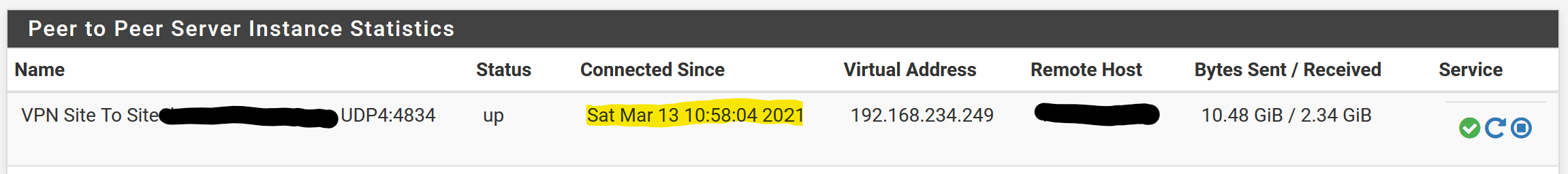

      The strange thing is that it is connected since 4 days on the server:
