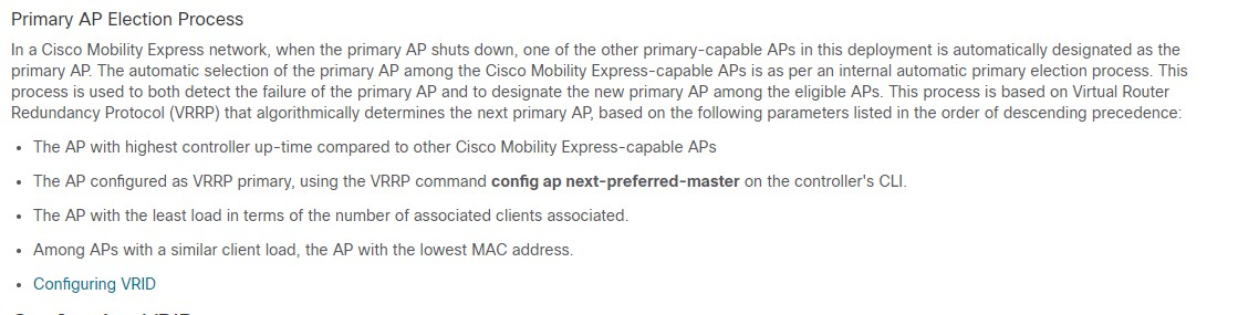

            You can't avoid this, it's a multicast address (VRRP) that Cisco uses to configure Mobility Express
            like mine ๐Ÿ˜‰
            +++edit:
            https://www.cisco.com/c/en/us/td/docs/wireless/access_point/mob_exp/88/user_guide/b_ME_User_Guide_88/appendix.html
