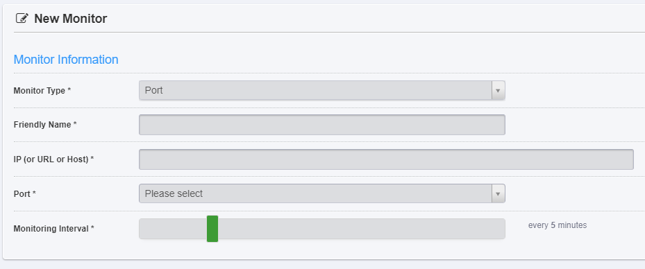

      I want to monitor the status of my internet connection.
      I would like to use the UpTimeRobot service which allows me to check remotely that the IP of my ISP is still available.
      As I can't ping for security reasons, I wanted to know if I could open a specific port that would allow me to do this test?
      If so, how can I do it?

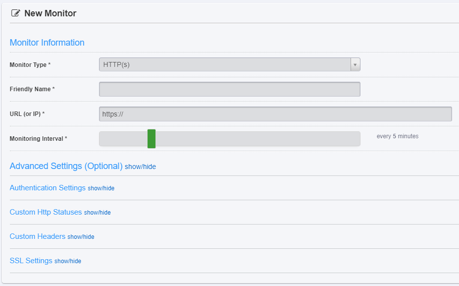

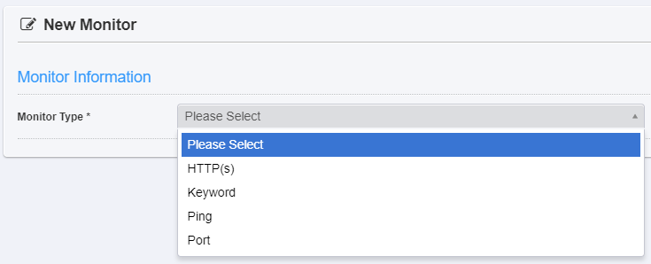

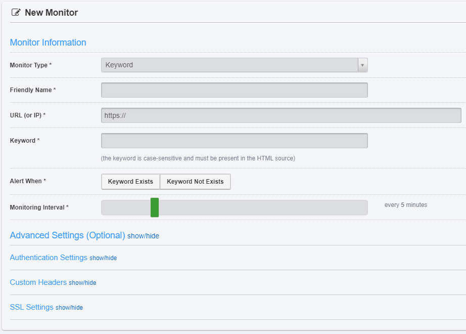

      Here is what UpTimeRobot allows.
      Best Regards.
