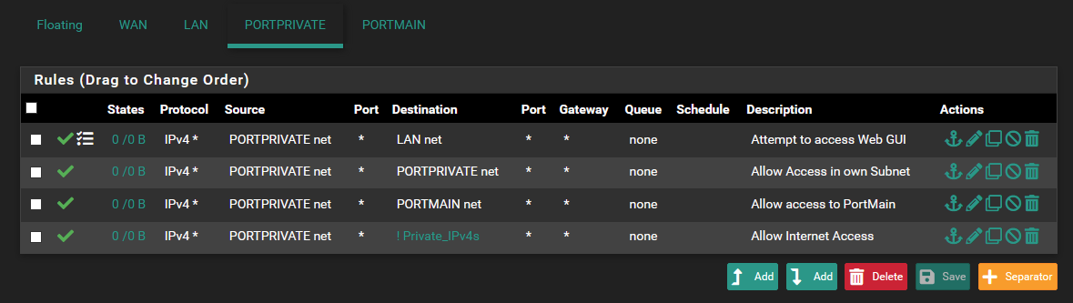

      I'm wanting a setup where no devices stay connected to LAN during normal use, and will only be connected through the OPT1-4 ports with the bare minimums allowed to pass the firewall rules.
      I'm having trouble getting the OPT1 interface to be able to access the WebGUI. The WebGUI is running at 192.168.10.1:44350, the device I'm testing with is on OPT1 at 192.168.20.10.
      Rules can be seen in the screenshot below. I've spent way too many hours trying to get this to work. All the tutorials I've seen, seems like these rules should work. The first rule can be seen passing via the logs. Trying to ping 192.168.10.1 (LAN) from 192.168.20.10 (OPT1 - PORTPRIVATE) results in a timeout.
      Even though the rule passes, the GUI will still time out.
      Hopefully this is enough information, let me know if you need more. Thanks.
        johnpoz LAYER 8 Global Moderator @fearnight
        Well a bit off topic, but your rule there to allow access to own subnet is pretty pointless. Pfsense has nothing to do with access to devices talking to each other on their own network.
        What seems odd, while I see your firewall logs showing rule was allowed. How come the rule shows no hits.. that 0/0 shows not hits to the rule.
        Are you doing something odd in outbound nats?
        Are you doing anything with ips or proxy?

          @johnpoz I had been clearing the state tables trying to see if that changed anything. Must have happened between taking the screenshots. I just tried again and here is the state table on the Web GUI rule.
          The "Own Subnet" rule was needed because my last rule would block any destination in any private subnet. It's a rule just for internet access only.
          I have not changed anything in the NAT rules from the defaults. I was going to looking into that next.

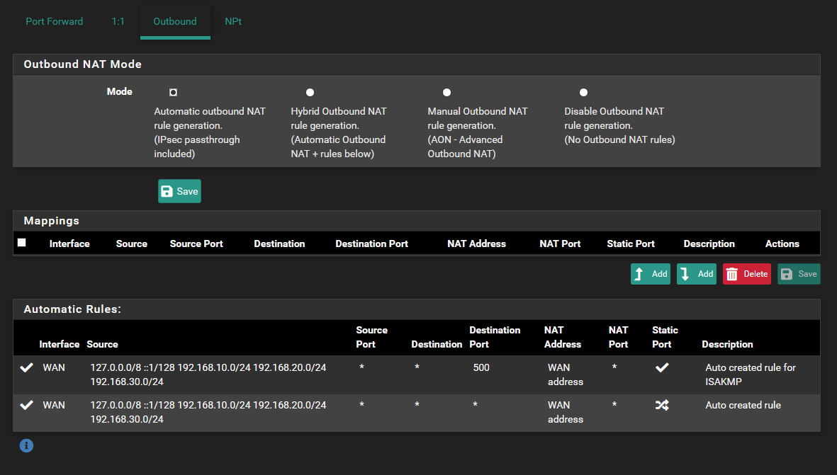

              Here are the outbound NAT rules
              No floating rules or VPN set up yet.

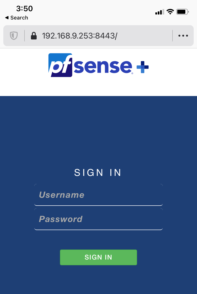

                You an see mine listening on the port I have set
                [21.02-RELEASE][admin@sg4860.local.lan]/var/dhcpd/var/db: netstat -anL | grep .8443
                tcp6  0/0/128                          *.8443
                tcp4  0/0/128                          *.8443
                And I can access it just fine fro one of my vlans. Here is me hitting it from my phone.
                You can view the state
                Since you show syn sent, but no answer.. dest didn't see the traffic or not listening on that port, etc.

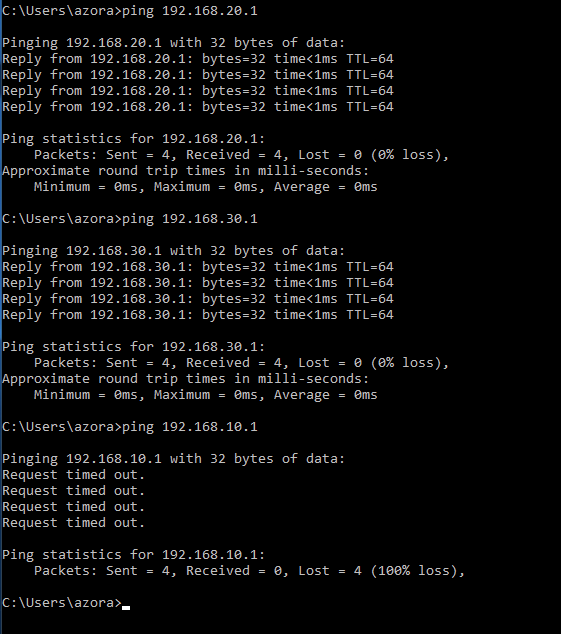

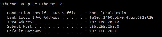

                            Any -> Any rule for testing
                            Showing local address at 192.168.20.10
                            192.168.20.1 ping success
                            192.168.30.1 ping success
                            192.168.10.1 ping timeout
                            pfSense version is 2.5.0-RELEASE
