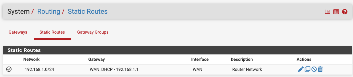

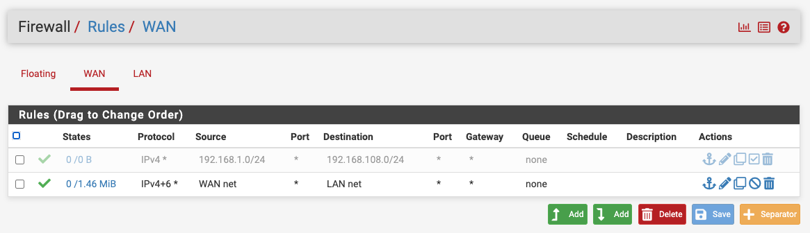

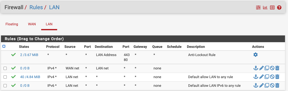

      Here's what my simple home network looks like
      192.168.1.1 fritzbox (internet gateway, connected to ISP)
      pfsense (WAN 192.168.1.4; LAN 192.168.108.1)
      network switch (pfsense, fritzbox and pretty much everything is connected to it)
      laptop (wifi connected to fritzbox)
      desktop (192.168.1.44)
      laptop (192.168.1.45)
      My pfsense configuration looks like this
      Sidenote: I have tried OPNSense with virtually identical configuration with no trouble. Also have OpenWRT in similar setup for different subnet also working with no trouble
      Any ideas?
