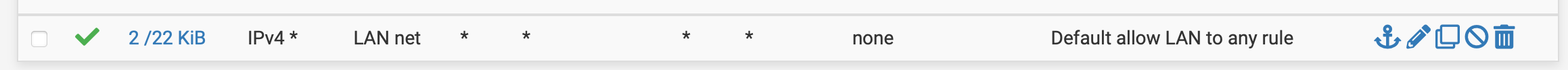

      I used to be able to ping hosts on the LAN hosting my OpenVPN server. I also used to be able to mace VNC connections to hosts. Both time out now.
      What I can do is make ssh connections and then tunnel the VNC traffic through the ssh connection. But that’s not what I deployed OpenVPN for.
      Did something get messed up with the firewall rules? I have
      for LAN,
