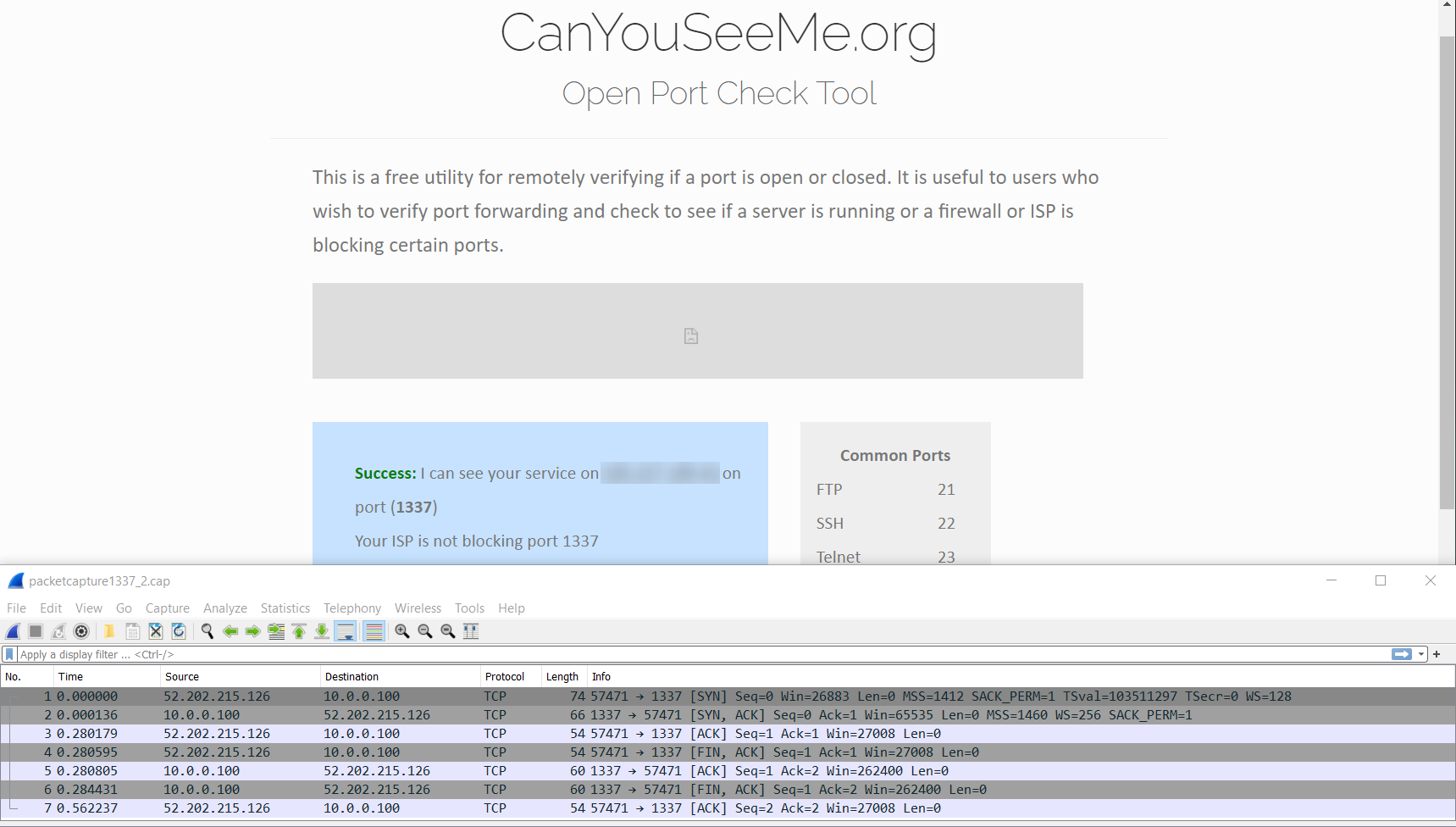

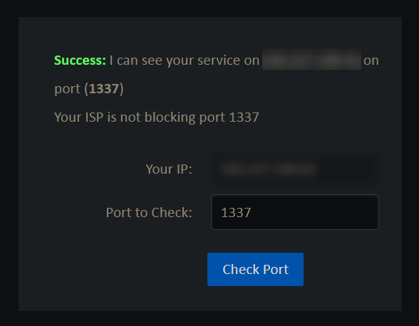

      Note both WANs are PPPoE, port forwarding is working on WAN1 but not on WAN2. I also did check directly the ISP is not blocking the port.
      WAN1:
      WAN2:
      NAT Rules:

          2 port forwarding rules. It was working just fine on 2.4.5.
          If you follow the packet flow with tcpdump/packet captures, where does it go?
          WAN1: (Working)
          WAN2: (Not Working)
          • jimpJ Offline
            Are those captures on the LAN? If so, what shows up in a capture on WAN2?
            The only known issue with port forwarding on multiple WANs was fixed in the build you are running. It works here on everything I have now.
            It's possible there is another edge cases with multiple PPPoE WANs but my second WAN here is PPPoE and it works fine on the latest snapshot, but didn't work on earlier builds.
            Do not Chat/PM for help!
            coldfire7C 1 Reply Last reply Reply Quote 0
            • coldfire7C Offline
              coldfire7 @jimp
              @jimp
              Yah on LAN, the 2nd screenshot is WAN2 and the 1st screenshot is WAN1.
