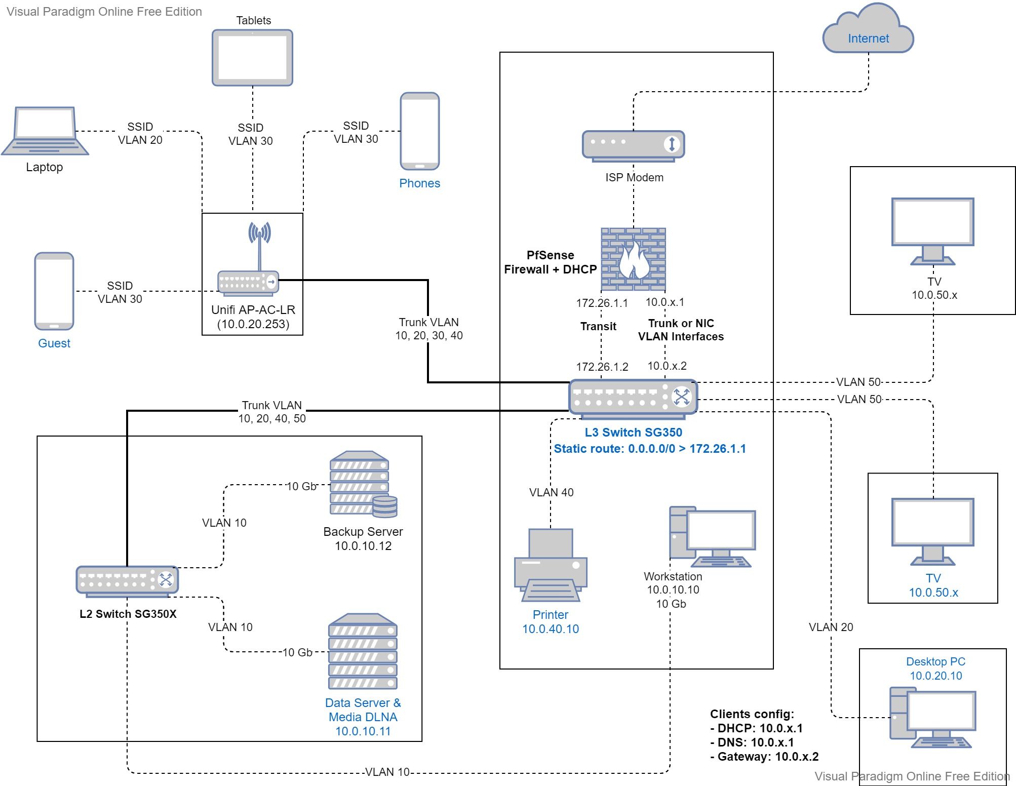

      I managed to properly set a transit route and VLANs on the L3 Switch + static routes on pfSense. DHCP on the Switch. That works as expected.
      Now, and hope you don't loose your mind, I wanted to get my self some learning.
      I managed to cascade the L3 switch and pfSense + use the DHCP on pfSense:
      • tracert shows all interVLAN traffic not reaching pfSense
      • internet works for all VLANs
      • pfSense DNS resolver and DHCP work for each VLAN and I can assign specific DNS servers (openDNS) to given clients which is a big plus for my needs
      • I can properly RDP between VLANs and from WAN to VLANs
      • speed tests and regular use show no issues on teh WAN side
      Clients manual config:
      • Gateway: 10.0.x.2 (L3 Switch)
      • DNS: 10.0.x.1 (pfSense)
      • DHCP server: 10.0.x.1 (pfSense)
      • (optional: set by DHCP)
      L3 Switch:
      • Static route: 0.0.0.0/0 > 172.26.1.1 (configured for internet access)
      pfSense:
      • No static routes since the VLAN interfaces are defined
      • DHCP for each interface points to L3 Switch interface as the gateway
      • Firewall rules on the Transit interface to allow WAN traffic for all VLAN interfaces
      • Firewall rules on the VLAN interface to allow/block traffic if needed
      Trace from VLAN 20 workstation:
      tracert 9.9.9.9
      Tracing route to dns9.quad9.net [9.9.9.9]
      over a maximum of 30 hops:
        1     1 ms     1 ms     1 ms  10.0.20.2
        2    <1 ms    <1 ms    <1 ms  pfSense.intranet [172.26.1.1]
        3     9 ms    11 ms     9 ms  77-56-224-1.dclient.hispeed.ch [77.56.224.1]
        4    11 ms    11 ms     9 ms  217-168-54-9.static.cablecom.ch [217.168.54.9]
        5    14 ms    11 ms    15 ms  ch-nax01a-rc1-ae-55-0.aorta.net [84.116.204.249]
        6    14 ms    10 ms     9 ms  ch-gva01a-ri1-ae-0-0.aorta.net [84.116.133.154]
        7    10 ms    10 ms    15 ms  cixp-packet-clearing-house-as42.cern.ch [192.65.185.182]
        8     9 ms     9 ms    12 ms  dns9.quad9.net [9.9.9.9]
      Trace complete.
      Trace between VLAN 10 <-> 20 workstations:
      tracert 10.0.20.10
      Tracing route to 10.0.20.10 over a maximum of 30 hops
        1     1 ms     1 ms     1 ms  sg350.intranet [10.0.20.2]
        2    <1 ms    <1 ms    <1 ms  10.0.20.10
      Trace complete.
      tracert 10.0.10.10
      Tracing route to 10.0.10.10 over a maximum of 30 hops
        1     1 ms     1 ms     1 ms  sg350.intranet [10.0.10.2]
        2    <1 ms    <1 ms    <1 ms  10.0.10.10
      Trace complete.
      InterVLAN Traffic doesn't reach pfSense and is no longer asymmetric in this way.
      However, I see a potential asymmetric issue with WAN traffic because downstream traffic will probably not pass through the transit, but directly to the VLAN, right ?
      For a controlled use, is that a real concern ? Do you have examples of failed use / issues so that I see if I should be concerned.
      Sure the transit only method is the most conventional and clear. I fully agree. However, I would really like a feedback on this setup.
      Thank you for your patience

                          • P Offline
                            phil80 @PM_13
                            @pm_13
                            No, I use ACLs binded to ports and interfaces (VLANs). That was the main reason to segment: secure by interface and not by IP/MAC only, both easy to spoof.
                            But sure, ACLs are not stateful (on my switch), so depending on the needs...
                            I just setup "Services Servers" on a dedicated VLAN and limit access by port/protocol + have proper permissions on the Services Servers. You just cannot easily limit one direction only initiated traffic from one VLAN to another
                            • P Offline
                              phil80 @phil80
                              @elodie80 said in L3 Switch and pfSense design advise:
                              @johnpoz
                              Still my question remains: why pfSense is allowing sloppy states and the anti-spoofing rules are not triggered with my previous setup for LAN <-> WAN traffic ? I see no difference in the firewall states at all !
                              Well, finally i found the topic answering my only real question in all this discussion
                              https://forum.netgate.com/topic/142983/how-does-antispoof-in-pfsense-work
                              So, it is by design and explains why my setup is working without any issues in near 2 years. The anti spoofing rule is never triggered here on the transit interface because I do explicitly allow internet traffic on this transit interface from specified (or any) subnets
                              Despite being uncommon and that it would be broken on other firewalls, pfsense design of anti spoofing rule gives this flexibility
                              Hope it can help other users that for some reason do not need a dedicated DHCP server
