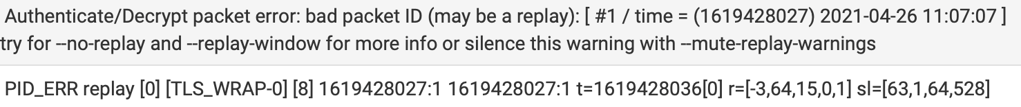

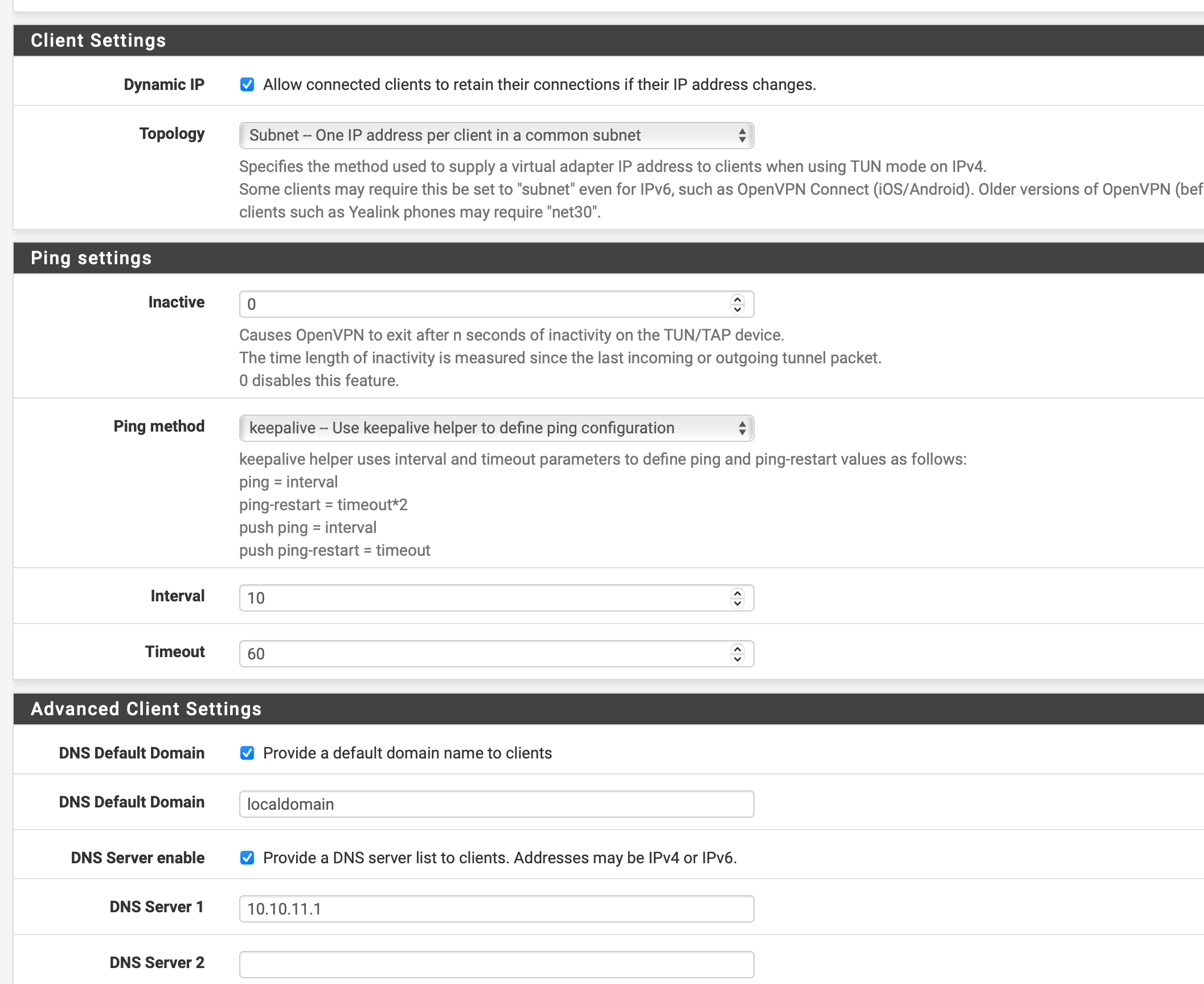

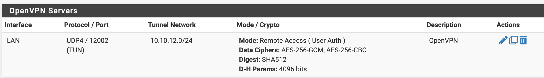

      Hey all,
      I have read a dozen posts but I haven't found a solution.
      I have updated to 2.5.1 on Friday - until then my openvpn server worked just fine for 1,5 years. until now
      any help is highly appreciated. thanks a lot
      the syslog for openvpn while connection:
      my config:
      V 1 Reply Last reply Reply Quote 1

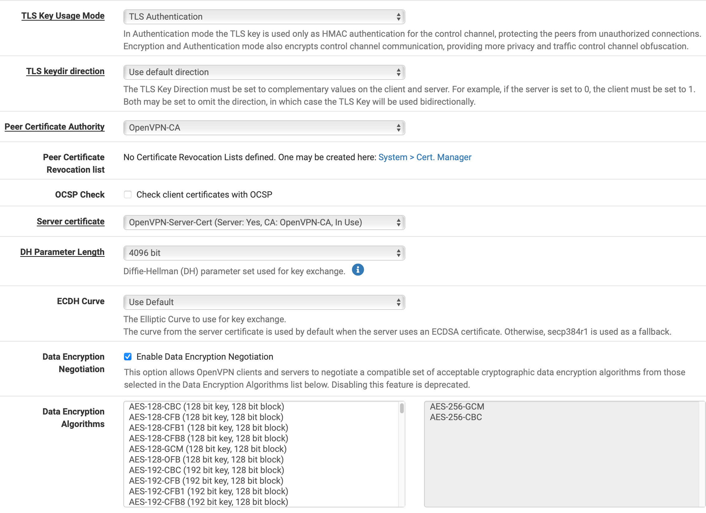

                  • V Offline
                    viragomann @paoloest
                    @paoloest
                    I believe, there were some thread here solved by unchecking "Data Encryption Negotiation". Maybe give it a try.

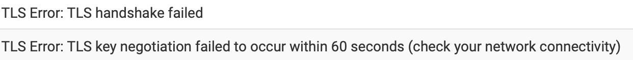

                      Jul 2 12:51:36 openvpn 20529 92.84.56.226:59685 TLS Error: TLS handshake failed
                      Jul 2 12:51:36 openvpn 20529 92.84.56.226:59685 TLS Error: TLS key negotiation failed to occur within 60 seconds (check your network connectivity)
