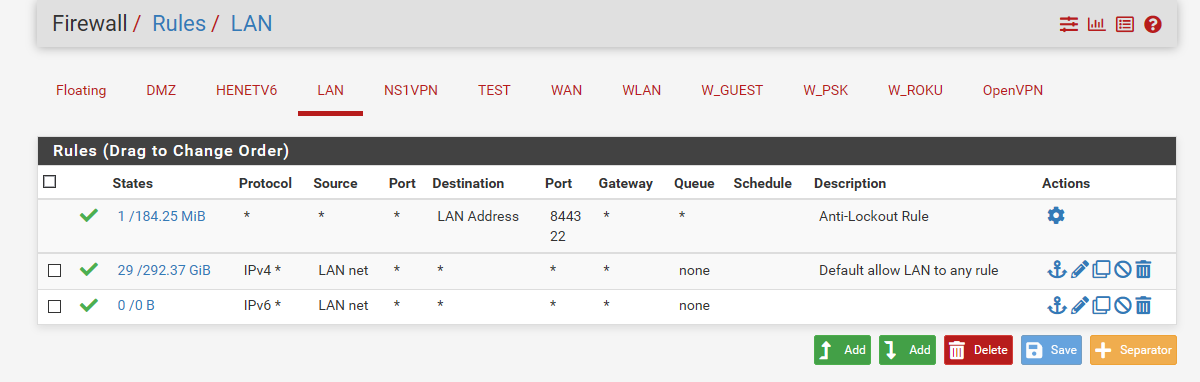

          Not on the wan it wouldn't be.. On the lan the default rules are any any, so unless that was deleted or modified.. There are no rules that would need to be created to get access out of the box.

              There is no rule that you would have to add.. Out of the box the lan has an any any rule.. Which would allow access to internet. Since really the internet could be any IP or any port..

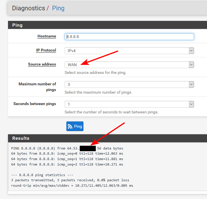

                  From pfsense - not your client?
                  See my ping before. If you can not ping 8.8.8.8 from pfsense.. Then something upstream is broken..Pfsense is not connected to the internet.. You say your gateway shows up and you can ping your gateway?

                      Well if pfsense can not even ping 8.8.8.8 from its wan - then it doesn't have internet. Unless whatever you have in front of pfsense is blocking 8.8.8.8?
                      Again - does your pfsense have a public IP on its wan? You say you bridged your modem.. And you say pfsense is able to ping its gateway?

                          NO RULE is needed to be added or adjusted to allow internet out of the box!
