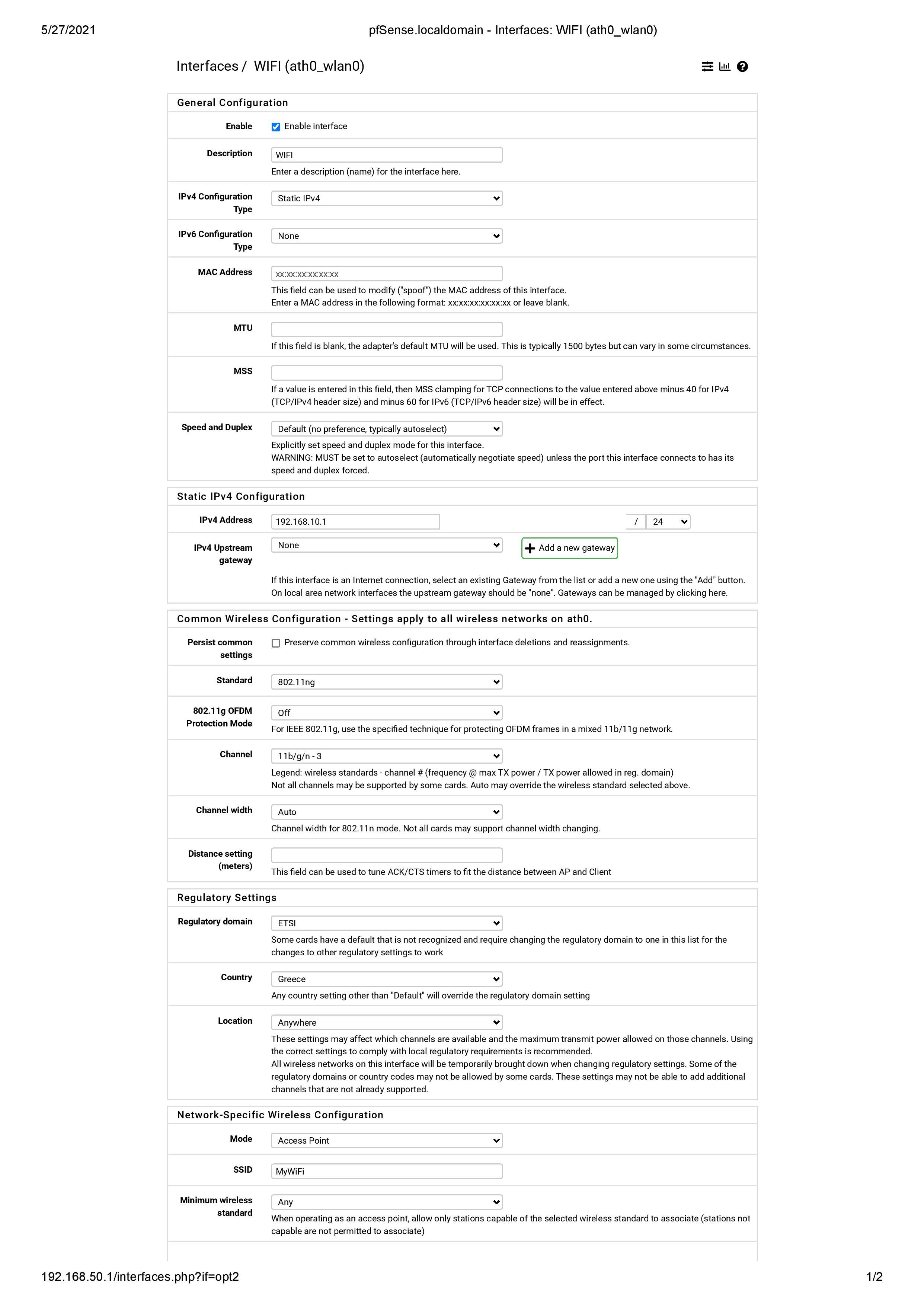

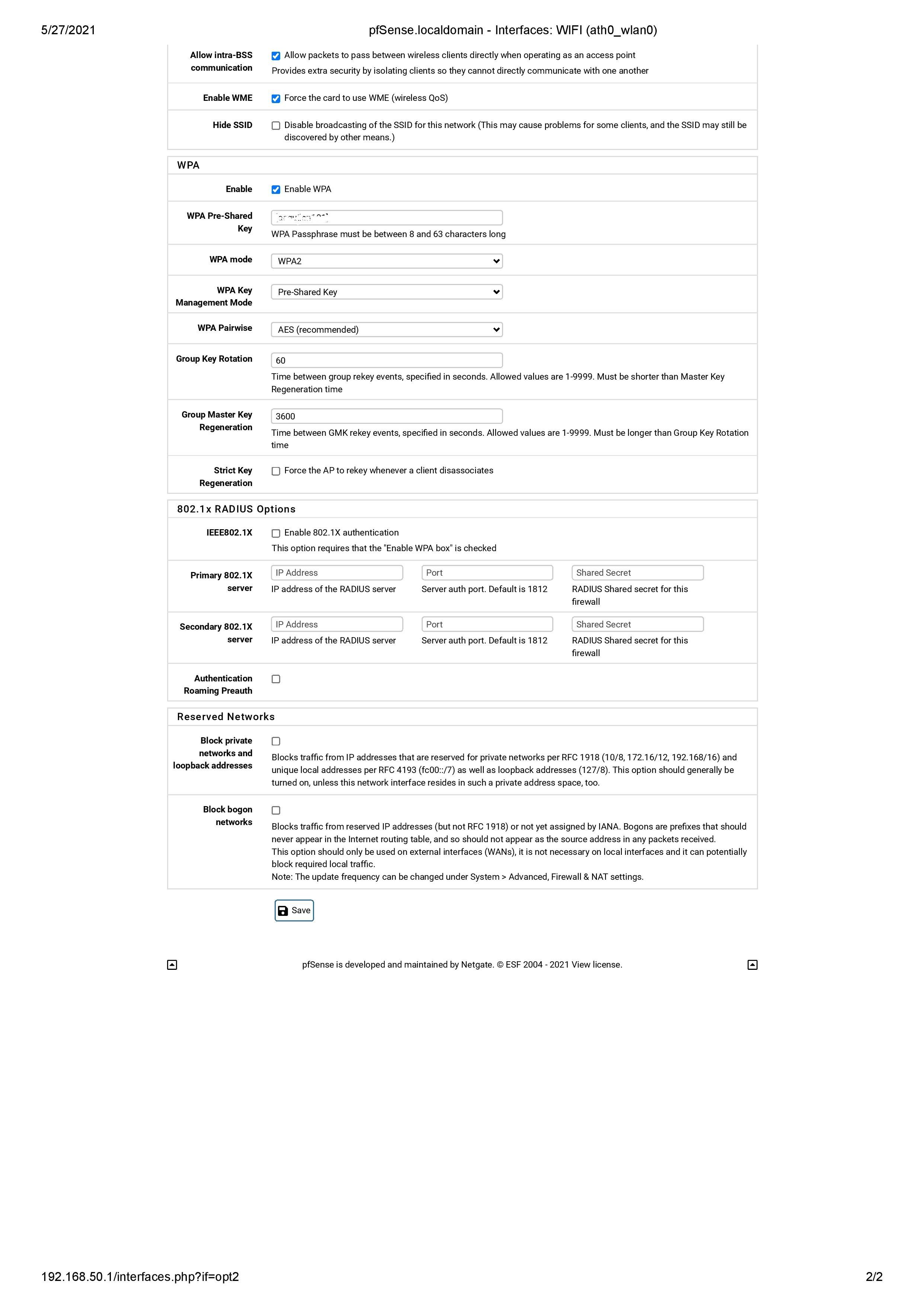

                            @gabacho4 Its not the house, I have a Cisco Linksys AP next to the PFSENSE box and it is able to cover my whole house

                                gabacho4 Rebel Alliance @biomecanoid81
                                @biomecanoid81 looking at your logs, I am seeing a ton of errors on your wireless interface. ( Significant Ipkt Ierrs and Opkt and Oerrs) Something doesn't appear to be configured right. Have you tried some different settings? Maybe set it to use g only or something like that? I'm taking stabs here as this isn't my realm of expertise and I'm sure you have figured out where I stand in the wireless card vs APs matter.

                                  • G Offline
                                    @biomecanoid81 i honestly don't know. I noticed the pfsense manual had a pretty explicit walkthrough for setting up wireless. If you read it and followed cool. If not, I'd do that and maybe start from scratch as far as configuring the wireless. Other than that you may have to play with the settings some. Try g or n or g and n but not b. B is ancient in the wifi world. Also you haven't said what frequency your card is using. 2.4 GHz or 5ghz? What is the frequency your Cisco uses, if not both? What channel does the Cisco use? Try to mirror your wireless card settings to the cisco ones as much as you can since you know the Cisco settings are good.

                                        biomecanoid81 @gabacho4
                                        @gabacho4 I am using 2.4Ghz since 5Ghz does not go that far. I will post screenshots of my settings when I get home.
