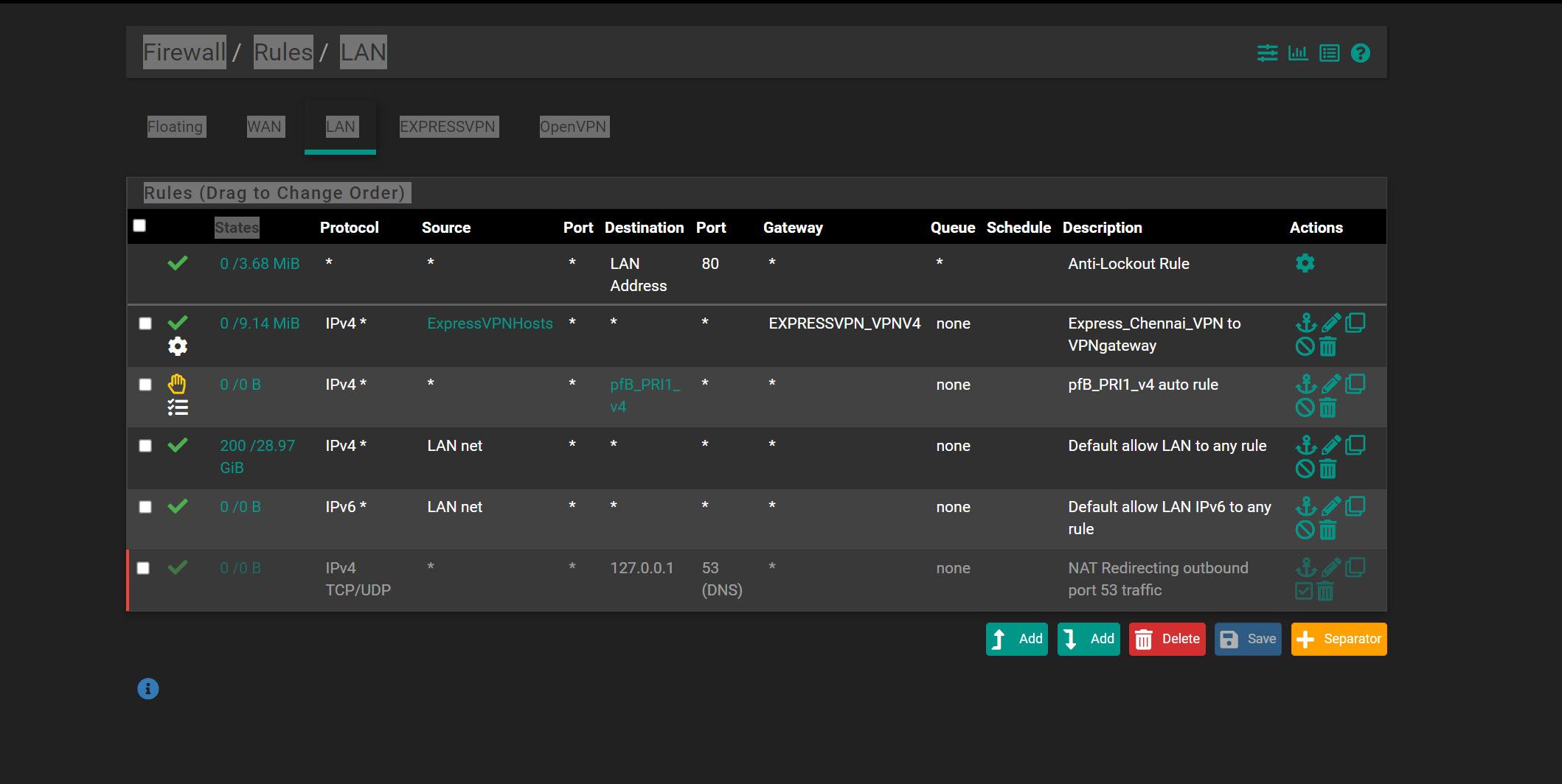

      Hi ,
      I am having a hard time in setting up the ExpressVPN , getting the below error message. Reachout to their support , they said its something wrong setting on the pfsense.
      May 26 15:00:23	openvpn	75963	VERIFY WARNING: depth=0, unable to get certificate CRL: C=VG, ST=BVI, O=ExpressVPN, OU=ExpressVPN, CN=Server-1417-1a, emailAddress=support@expressvpn.com
      May 26 15:00:23	openvpn	75963	VERIFY WARNING: depth=1, unable to get certificate CRL: C=VG, ST=BVI, O=ExpressVPN, OU=ExpressVPN, CN=ExpressVPN CA, emailAddress=support@expressvpn.com
      May 26 15:00:23	openvpn	75963	VERIFY OK: depth=1, C=VG, ST=BVI, O=ExpressVPN, OU=ExpressVPN, CN=ExpressVPN CA, emailAddress=support@expressvpn.com
      May 26 15:00:23	openvpn	75963	VERIFY OK: nsCertType=SERVER
      May 26 15:00:23	openvpn	75963	VERIFY X509NAME OK: C=VG, ST=BVI, O=ExpressVPN, OU=ExpressVPN, CN=Server-1417-1a, emailAddress=support@expressvpn.com
      May 26 15:00:23	openvpn	75963	VERIFY OK: depth=0, C=VG, ST=BVI, O=ExpressVPN, OU=ExpressVPN, CN=Server-1417-1a, emailAddress=support@expressvpn.com
      May 26 15:00:23	openvpn	75963	Control Channel: TLSv1.3, cipher TLSv1.3 TLS_AES_256_GCM_SHA384, 2048 bit RSA
      May 26 15:00:23	openvpn	75963	[Server-1417-1a] Peer Connection Initiated with [AF_INET]0.0.0.0:1195
      May 26 15:00:25	openvpn	75963	SENT CONTROL [Server-1417-1a]: 'PUSH_REQUEST' (status=1)
      May 26 15:00:25	openvpn	75963	AUTH: Received control message: AUTH_FAILED
      May 26 15:00:25	openvpn	75963	SIGUSR1[soft,auth-failure] received, process restarting
      May 26 15:00:25	openvpn	75963	Restart pause, 10 second(s)
      May 26 15:00:35	openvpn	75963	WARNING: --ns-cert-type is DEP
      2021-05-24_14-02-09.jpg 2021-05-24_14-02-38.jpg 2021-05-24_14-03-26.jpg 2021-05-24_14-04-29.jpg
      KOMK 1 Reply Last reply Reply Quote 0
      • KOMK Offline
        KOM @Jegavelan
        @jegavelan I would get rid of all your custom options and try working with it with defaults. A lot of your custom options are controlled by elements in the GUI. Second, I would increase the verbosity level of the logs so that you might see more about this auth failure. Are you SURE you have the correct username and password? Have you grabbed a copy of an ExpressVPN OpenVPN config file and looked at it for its settings and compared them to what you have done on pfSense?
          Jegavelan @KOM
          @kom Yes verified that 100 time by now. Now removed the custom options and set the log to 10

                                    Jegavelan @Gertjan
                                    @gertjan I removed all the existing certs and configuration and re-created everything like what you have now.
                                    I got rid of the auth_failed error now , but VPN is not getting connected. Attached other configuration and logs.

                                    NAT01.jpg NAT.jpg Hostcollection.jpg Firewall Rules.jpg Firewall Rules 01.jpg DNS.jpg
                                      Gertjan @Jegavelan
                                      @jegavelan
                                      Your Manual NAT entries, and the second LAN firewall rule look fine to me.
                                      These :
                                      are Floating rules ?
                                      if so, then that's not looking fine at all ..... Why did you create these rules ??
                                      Same thing for DNS settings : not needed at all.
                                      Make first a minimal Client VPN setup with https://www.youtube.com/watch?v=lp3mtR4j3Lw
                                      Btw : when the VPN client is connected = working, drop the verbosity of the VPN log - reset it to 3. It's not needed to see enties for every byte that goes out. It tends to hide crusial information.
                                      @jegavelan said in Express VPN Received control message: AUTH_FAILED:
                                      I used the info from my vpn's account page.
                                      And this one : https://www.expressvpn.com/fr/support/vpn-setup/pfsense-with-expressvpn-openvpn/
                                      Keep in mind that OpenVPN had a huge update a couple of month ago : the version used back then was 2.4.7 ( ? ) and now pfSens is using the version 2.5.1 - the future, upcoming version will be 2.5.2. This means that this ExprssVPN / pfSense help page should be double checked with the new and changed OpenVPN parameters. It's not a click here click there and go solution.
                                      Also : I don't know what version of OpenVPN ExpessV
                                      N is using on their side. I do know that my setup worked last time I tested it, using pgSense 2.5.1 and OpenVPN .
                                      4 1 Reply Last reply Reply Quote 0
