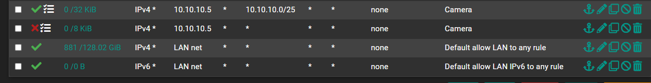

            Rules for that camera:
            johnpozJ V 2 Replies Last reply Reply Quote 0
              johnpoz LAYER 8 Global Moderator @blaz23
              @blaz23 Please post rules on your lan and this vlan you put your camera in.
              That first rule you have there posted is pretty pointless. As mentioned already pfsense has nothing to do with traffic internal to a network/vlan - only to get off of it.
              That rule would allow this 10.10.10.5 to talk to pfsense IP in 10.10.10.0/25 - but better to use the alias optX address.
              Is 10.10.10.0/25 your lan or this network/vlan?
              Rules are evaluated as traffic enters pfsense from the network attached. Top down, first rule to trigger wins, no other rules are evaluated.
              Return traffic is allowed via state. But if you want to allow unsolicited traffic from vlan A to B, the rules need to be on vlan A.
              Understanding the IP ranges you using for your 2 different networks/vlans and the rules on each will help us help you figure out what is not correct. So are you using say 10.10.10.128/25 on this other network?
