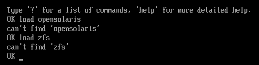

          @jimp thanks for the help, the load commands fail:
          What command/interface can I use to edit /boot/loader.conf.local?

            If they won't load from there, they wouldn't load from loader.conf.local.
            Might be a disk issue. ZFS generally doesn't have problems like UFS with the filesystem becoming corrupt so I doubt it's related to that, but it is odd that it doesn't find those files from the loader.
            The fastest way to recover is to reinstall and restore a backup at this point.

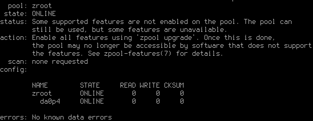

                      What shows up in zpool status on these?

                        @jimp Here is the result:
                        zpool status
                        • jimpJ Offline
                          Maybe try updating the pool it to get around those errors:
                          zpool upgrade -a
                          gpart bootcode -b /boot/pmbr -p /boot/gptzfsboot -i 1 da0
                          Though I'd still say your safest bet is to reinstall and restore the configuration. You should even be able to use the "Recover config.xml" option in the installer to make it simpler.
