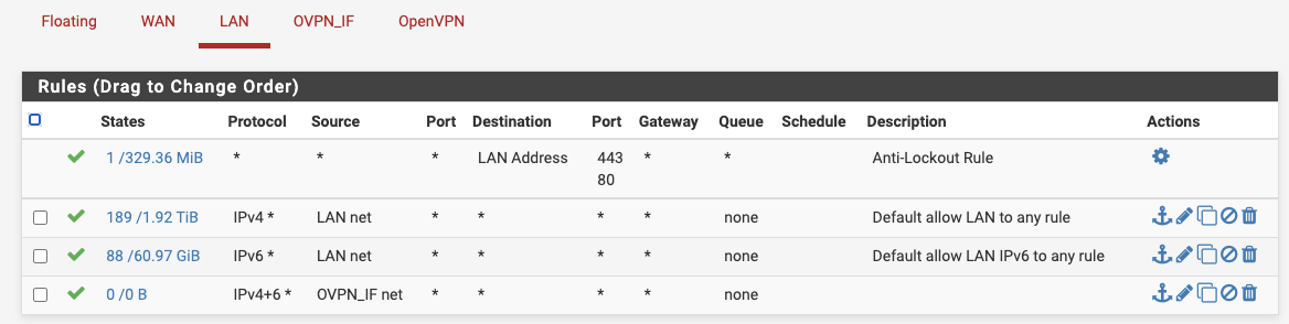

 WAN - 100.77.0.23 and IPv6 2a00:6020:1000:1d:abc:beef
 LAN - 192.168.88.1 and IPv6 2a00:6020:1920:c01d:c01a:1324:beef:babe

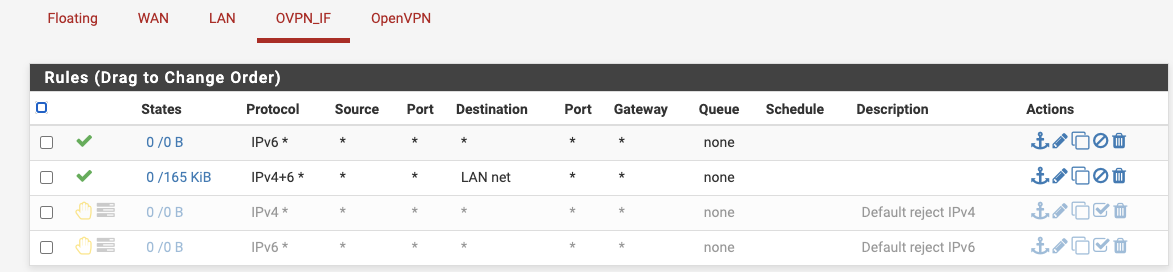

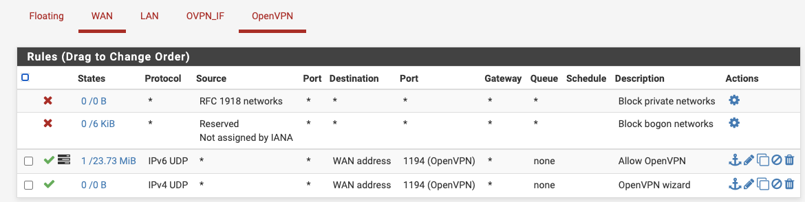

 OVPN_IF - 192.168.77.1 and IPv6 2a00:6020:1000:1d::1Firewall rules - the logs look clean
 I think these rules are too permissive from my half-understanding of things I have read but would fix this after getting things working.My guess here is that maybe the IPv6 Tunnel Network I set in the OpenVPN server is wrong - I just guessed based on the WAN IPv6 address (see interfaces above) and used 2a00:6020:1000:1d::/64 but why ping would work and web pages not doesn't seem consistent. Otherwise perhaps there is some weird option set somwehere. Any help gratefully received.

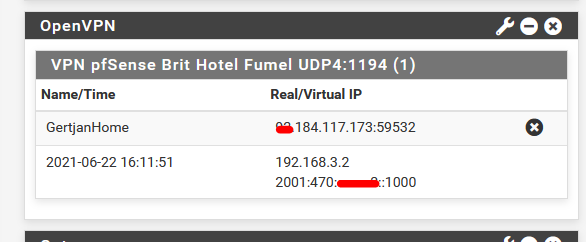

 After all : the Internet gods will come after you if "2a00:6020:1000:1d::/64" is assigned to some one ;))@charry2014 said in OpenVPN connects, can ping LAN hosts but no web pages load: On the Dashboard the OpenVPN Gateway is always Offline That's not a good sign.  As I'm using 192.168.3.0/24 and 2001:470:xxxx:3::/64 - I own both of them, as 192.168.3.0/24 is RFC1918 and 2001:470:xxxx:3::/64 is part of an IPv6 network that I'm allowed to use. The tunnel goes over IPv4 (I guess / I don't care ^^). @charry2014 said in OpenVPN connects, can ping LAN hosts but no web pages load: I read that adding the Advanced Configuration option push "route-ipv6 2000::/3";

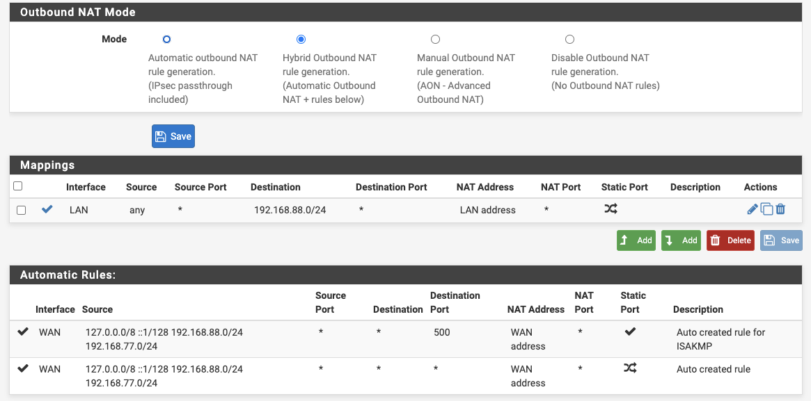

 @charry2014 said in OpenVPN connects, can ping LAN hosts but no web pages load: It it just web pages hosted by servers on my LAN which don't. So that looks like just a NAT problem?
 And for the tunnel you still could use IPv4, even if the tunnel is running over IPv6 I guess.
 It could be - previously in my OpenVPN configs the automatic NAT just worked so I am a bit confused what settings I should use. I read around a bit and ended up with what is below - but the automatic outbound NAT gives the same behaviour.  Can you help me get this working?
