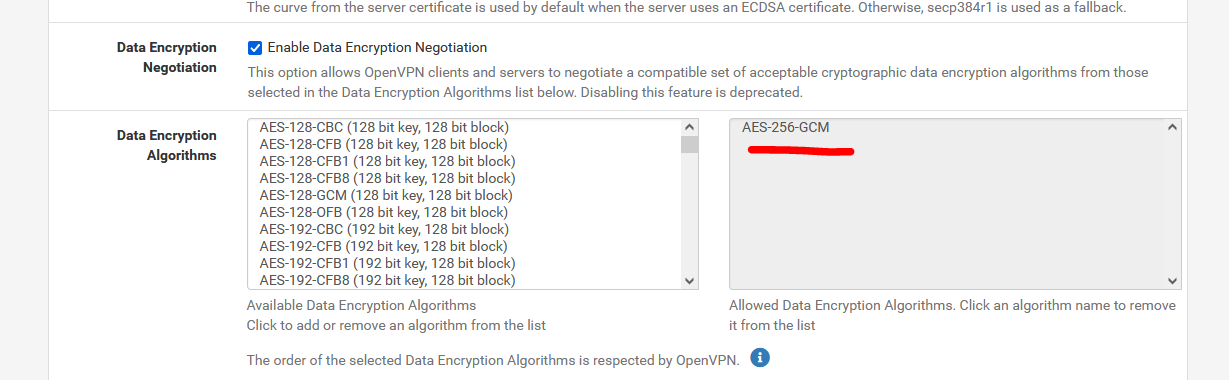

          I've set :
          So, no surprise, I see in the logs the same thing :
          2021-07-15 12:44:55.799700+02:00 openvpn 48505 GertjanHome/92.184.123.121:55566 Outgoing Data Channel: Cipher 'AES-256-GCM' initialized with 256 bit key
          I also saw the same thing on the client side - in the logs of my Phone..
