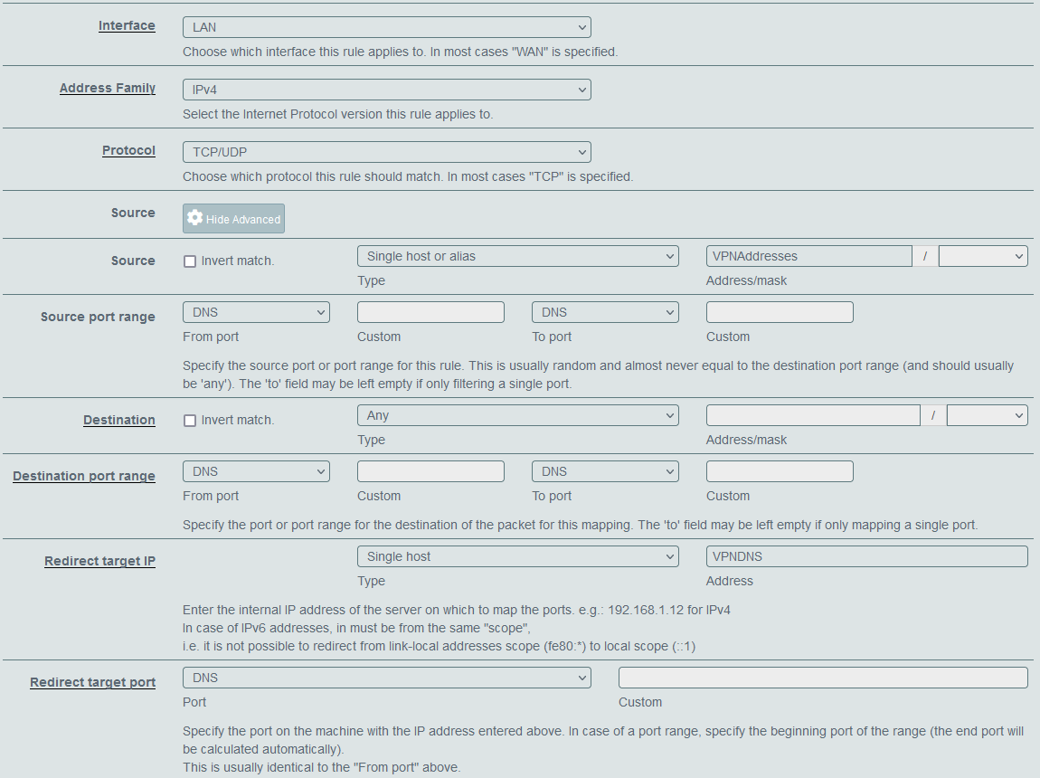

                                  • DraghmarD Offline
                                    Draghmar
                                    Because I'm a little bit afraid I'm going to break something with DNS I'll ask if what I want to do is ok. :P
                                    I have Port Forward set using this recipe. My idea is to create alias with DNS from NordVPN and then create new Port Forward, above previous one. Choosing LAN as a interace I will add specific devices in the source field for port 53, destination will beset to any for port 53 and redirect IP to VPN DNS alias.
                                    Will that be enough?
                                    I saw in OpenVPN's Client Specific Overrides that I can set there DNS. Should I do that? I'd guess not but who knows. ;)
                                    • V Offline
                                      viragomann @Draghmar
                                      @draghmar said in [noob question] pfSense as a OpenVPN client for selected devices:
                                      The forwarding looks well, but you have also to direct that traffic to the VPN provider. This isn't done by NAT.
                                      You have to add a policy routing rule with the VPNDNS alias as destination and set the gateway to the VPN.
                                      This is used by VPN access servers to set certain directives for specific clients. It cannot be used in your case.
                                      Consider that the your "VPNAdresse"s may possibly use DoH for name resolution. To cover this, you have to direct their HTTPS upstream traffic to the VPN server by poilcy routing.
                                      DraghmarD 1 Reply Last reply Reply Quote 1
                                      • DraghmarD Offline
                                        Draghmar @viragomann
                                        @viragomann said in [noob question] pfSense as a OpenVPN client for selected devices:
                                        Isn't that added automatically? I have a rule like that from creating Port Forward from the recipe. I guess I'd have to edit this new one then to set VPN Gateway in advanced settings, right?

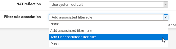

                                        • V Offline
                                          @draghmar
                                          Depends on the rule creation option:
                                          However, pfSenes cannot create a policy rule from a NAT, since there is no gateway info.
                                          So at best you can let it create an unassociated filter rule and edit it after to set the gateway.
                                          DraghmarD 1 Reply Last reply Reply Quote 0
                                          • DraghmarD Offline
                                            @viragomann I think I did everything but https://dnsleaktest.com still is able to detect my IP. :( I have Port Forward set as above and in the created rule I changed gateway to VPN one. What else am I missing?
