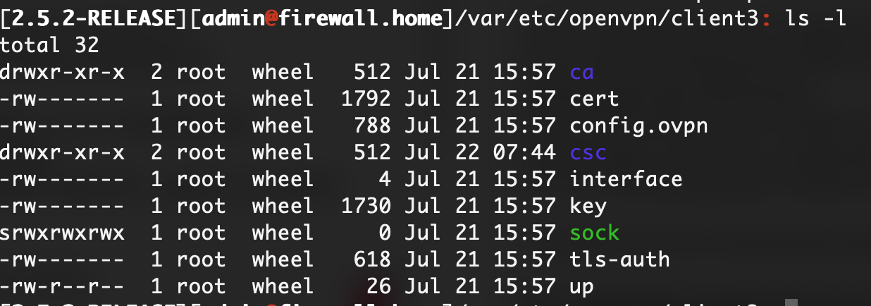

      I checked and the /var/etc/openvpn/client3/cert exists.

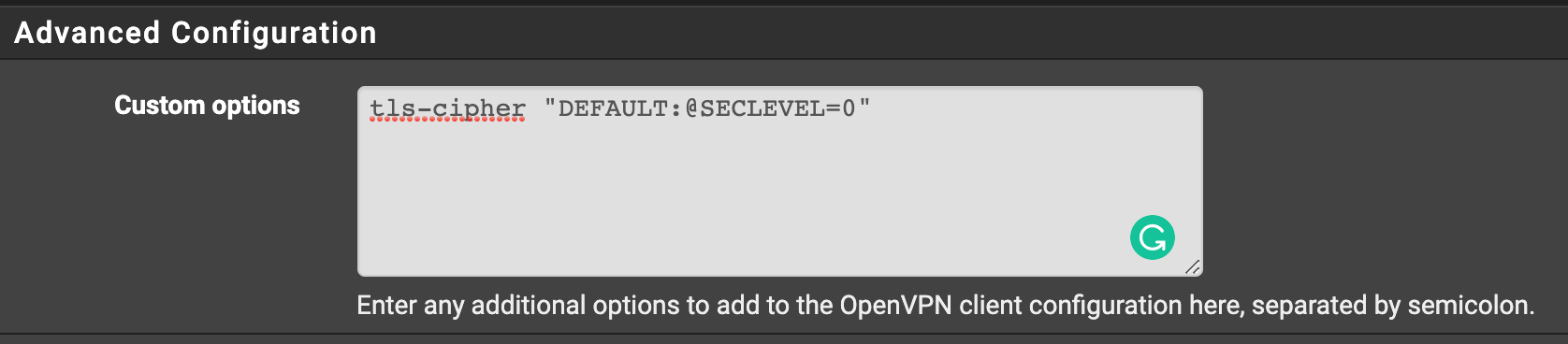

        Answering my own question...
        Adding this string to custom options allows things to work:
        tls-cipher "DEFAULT:@SECLEVEL=0"
        However, I am looking for a better way to do this.
