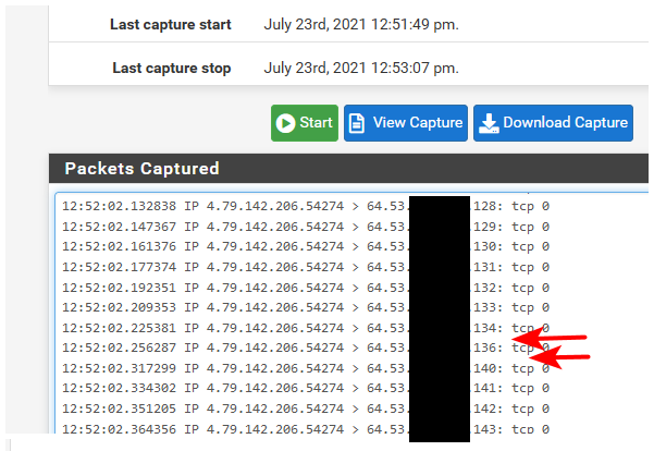

                mjgtp
                So yea... officially confused... tested the usual 1056 ports and this is what it caught. I'm really hoping it's just the way I captured, because this doesn't make any sense... the ports are repeating and they're NOT what I told it to test for.
                capture
                I'm a programmer by trade, but learning a WHOLE new level of respect for you network guys!
                • johnpozJ Online
                  johnpoz LAYER 8 Global Moderator @mjgtp
                  that looks like return traffic from you hitting website.. and not what was scanning.
                  the source port is 443, ie website you went too and whatever your source port was this 15623..
                  You will want to make sure you remove the 100 count limit when capturing or that will fill up quick after you start with you just talking to the website.
                  I can pretty much promise you there is no way pfsense is sending anything back that would show those ports "closed" vs the stealth.. If you had set pfsense to send rejects (which isn't something easy to do like a mistake in a button click or checkbox) - it should be sending them for all ports. Or you have those ports forwarded into something that could be sending a rst back and it showing closed.
                    mjgtp
                    That makes sense...probably those little boxes being sent back on the page. So if i'm capturing on the WAN interface... and all I see is the above, on an unlimited capture ("Count"=0), but no actual "real" port hits... it would be the ISP rejecting it?

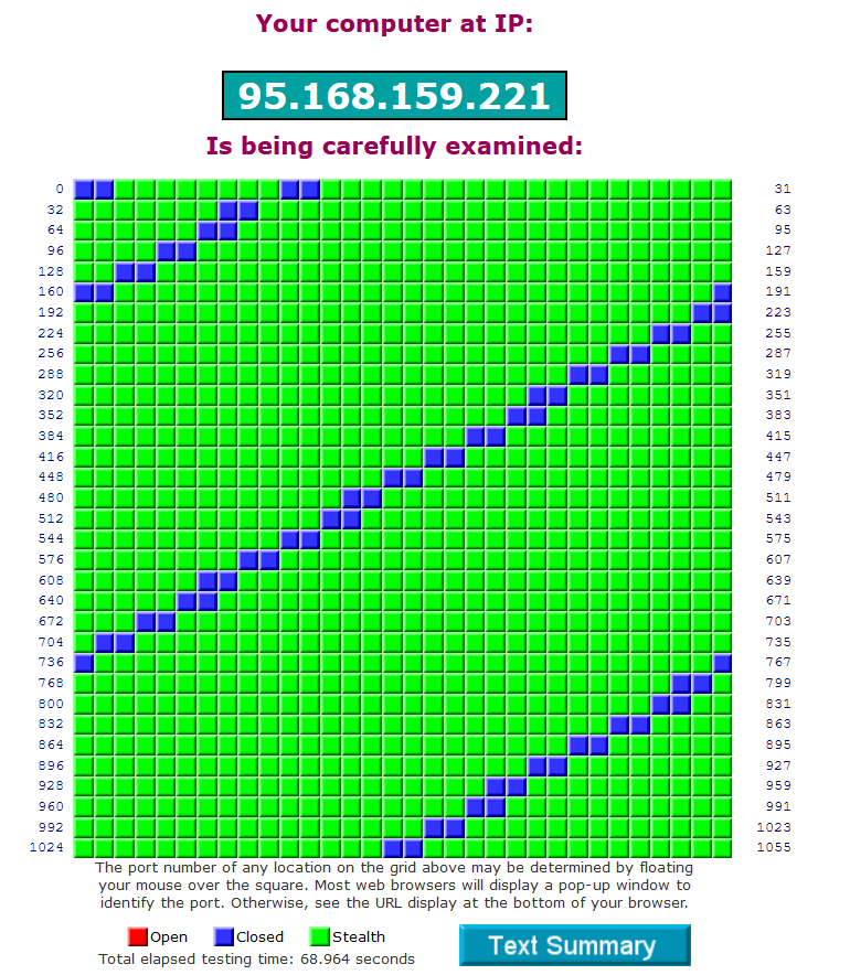

                            My old shitty cable-ISP used to do this, after maybe 60 days or so, I got this. I then had to manually reconnect and it was gone again and I had my open ports back.
                            Somehow it is still fascinating to me to look at. ๐Ÿ˜ฒ

                                @bob-dig ha that is odd graph to be sure.. WTF?? BTW, I take it that is some old IP, so no concern with posting that public IP?

                                  @johnpoz I never had a static IP with any ISP around here. And I even do things that those dynamic IPs change more often. ๐Ÿ•ต
