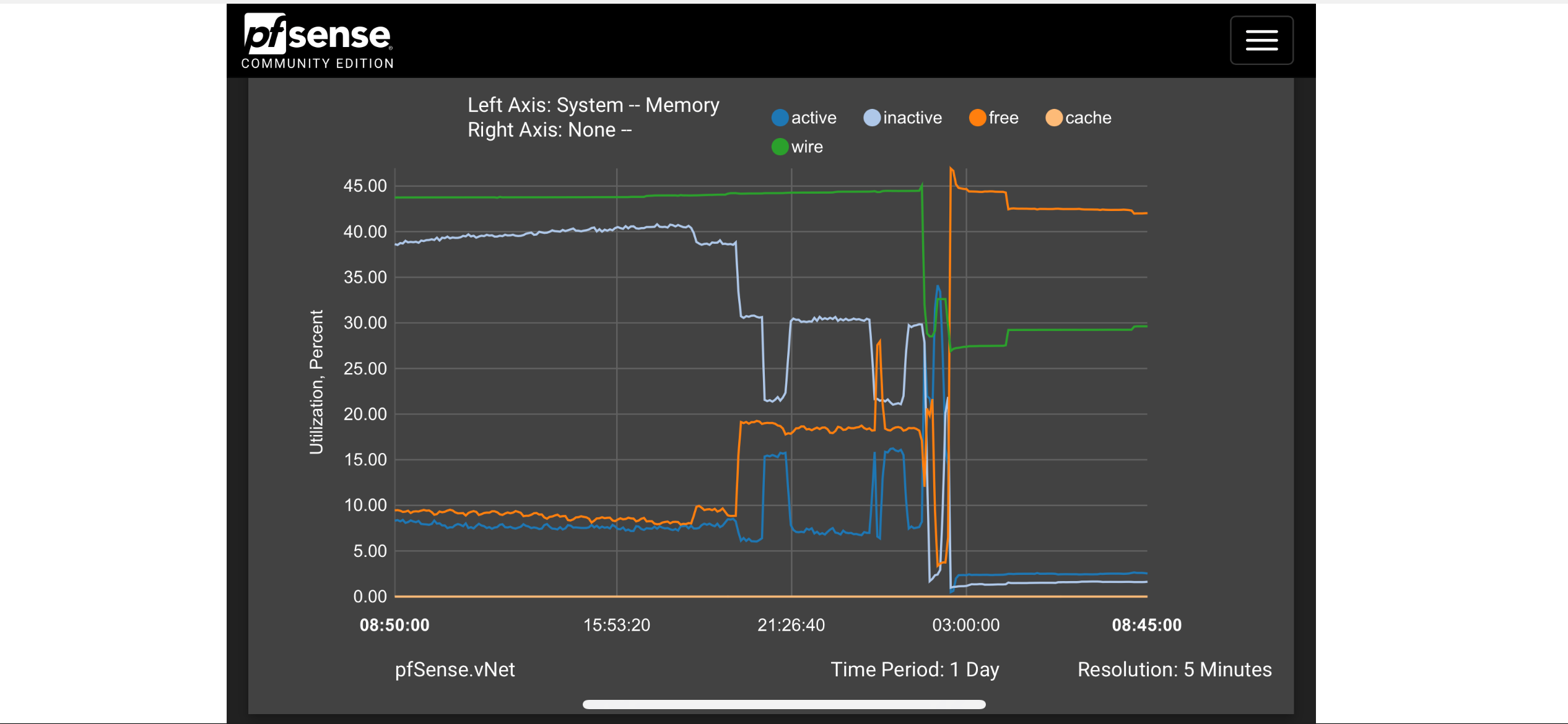

                        @gertjan thanks for the heads up! I left everything running for a week with python mode enabled in Unbound, pfBlocker IP enabled and DNSBL disabled… ran like a charm.
                        Enabled DNSBL last night with one Feed with 10k ish domains, so a pretty small list. Here’s the memory usage, staying consistent until I flipped the switch, within an hour unbound crashed with no obvious log.
