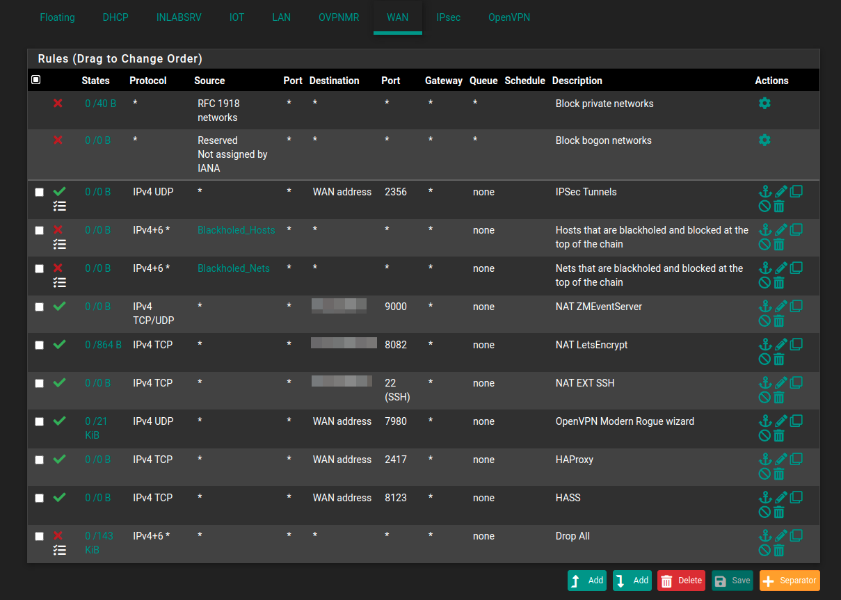

      Prior to 2.5.2, I had a rule that uses an Alias as the source, and the WAN Address as the destination, with Port 500 (ISAKMP), and this worked fine to allow my IPSEC tunnels to form. Since upgrading to 2.5.2, I've had nothing but issues, and I think I've tracked it down to the rule no longer matching. When looking at the log for ^500$ as the destination port, I see all traffic, even from the allowed sources, hitting the Drop All rule instead of matching my allowed rule, which is above the Deny All rule.
      I have tried using the specific IP, allowing ISAKMP from Any, etc, but I cannot get the rule to match on the firewall since upgrading. I have also switched to a different port, but no luck, still just smacks down to the Drop All rule. I even have gone so far as to delete the rule and manually recreate it, still no luck.

        screenshot of your rules ...
        floating rules in use ?
        interfaces still the same ? igb0 still igb0 ? in other words WAN is still WAN and LAN is still LAN after the upgrade.

          @noplan There are some floating rules from pfBlocker, but the log is calling out the Drop All rule specifically, which only exists on the WAN interface. In parathesis there is a number, 1579574159, which is unchanged so I'm assuming that's some rule identifier maybe? Anyway, literally, 2.5.1 everything worked, 2.5.2, no IPSEC tunnels. My WAN interface is still em0 after the upgrade, so that didn't change.
          Is there some advanced logging I can enable to trace the packet through the firewall tables to see why it's not matching my rule anymore? I also had the thought that maybe it's because it's UDP, but I also have OpenVPN set for my mobile devices, and that uses UDP and has no issues.
          Here's my WAN rules, you can see the Drop All way at the bottom, and the IPSec Tunnels all the way at the top (third from actually). I'm going to be changing everything back to the default ISAKMP (500/UDP) which has always worked prior to 2.5.2
