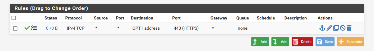

      I have added a firewall rule to allow HTTPS to the OPT1 interface address but the port still reports as being closed.

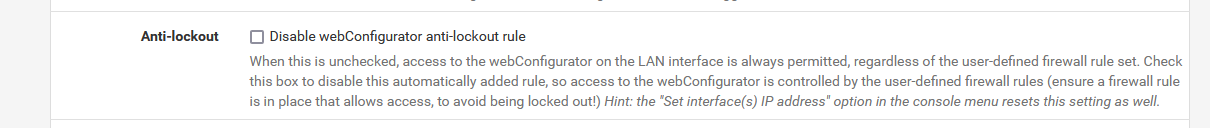

          Remember this one :
          When not checked, it creates a firewall rule on the LAN interface that permits access from the LAN to the pfSense GUI (and SSH access).
          This resembles your firewall rule on your OPT1 interface.
          But, be careful, this only passes IPv4 TCP traffic to port 443.

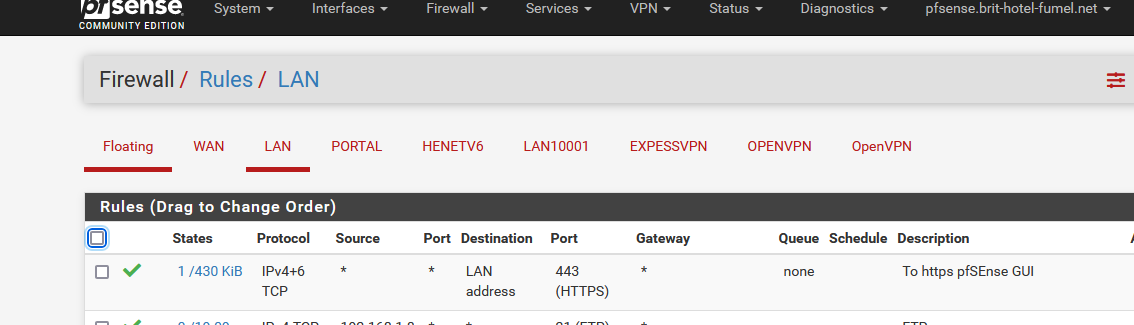

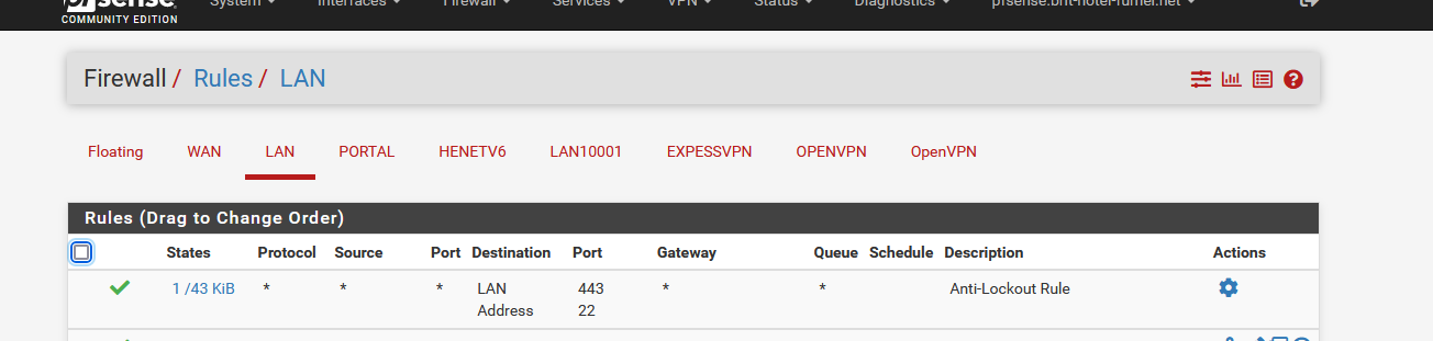

          As soon as I placed a rule like this on top of an interface (LAN for me) :
          the states counter started to raise ( the "1/443 KiB in the image)
          I had to shut down the browser, and reopen it to re engage new firewall states, so the first rule would 'intercept' and pass the traffic.
          Btw : I also had to add IPv6 as my browsers 'know' that my pfSense also speaks IPv6, as it is the default protocol on my LAN type networks. When I left out IPv6, my browser was unable to connect to the GUI ... strange, as it should fall back to IPv4 after some time.
