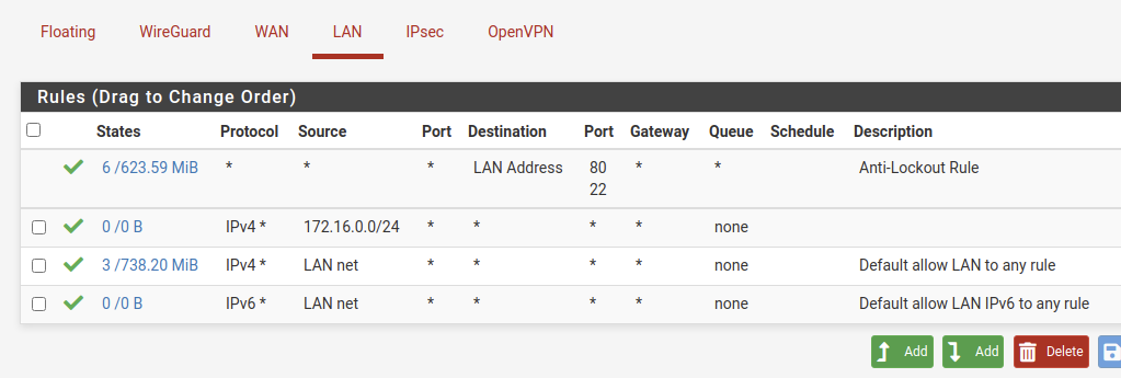

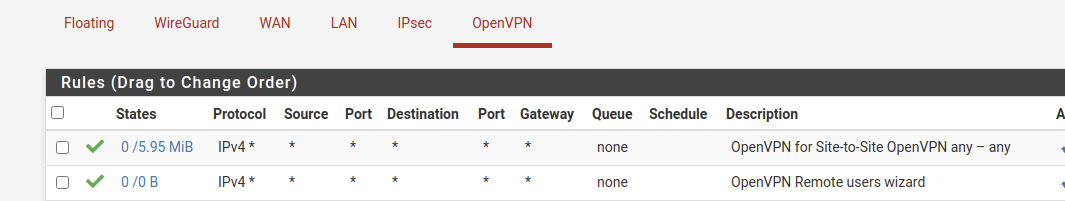

      1. Firewall:
        _
        Firewall rules (except one) created automatically, NAT / Outbound mode is set to auto. After the client is connected I can ping or use SSH to PFSense using 192.168.10.10 and 172.16.0.1 IPs.
      But I can't reach other servers in the 192.168.10.0/24 network from client. The servers are opened on 22/tcp port and PFSense can reach them.
