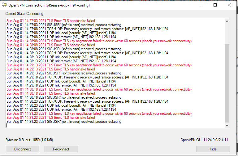

Here's what it shows when I try connecting my pc.
Not concerning your private ip on the log

for me it looks like you go no route to your vpn server
Why is the remote address a local one?

Again, your client tries to connect to a private IP. This let us assume that you OpenVPN servers WAN IP is behind a router.
So you have- to forward UDP 1194 to pfSense on that router
- in the client export utility enter your public IP or host name at "Host Name Resolution" and export a new config for the client
