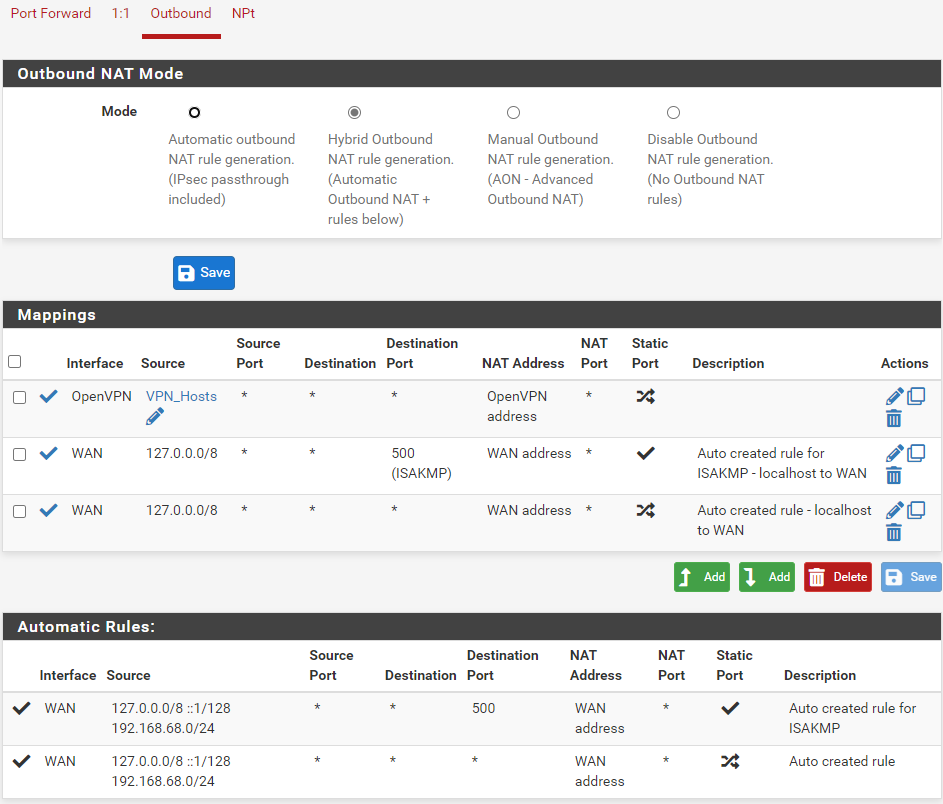

      Outbound NAT:

                Also I just saw that your outbound NAT rule isn't using the correct interface. You should change it to the VPN interface you have assigned to the client instance.

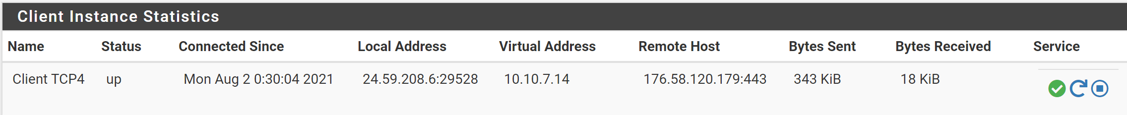

                  The VPN interface is up:

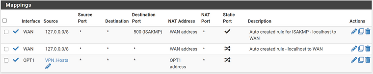

                  I thought it should point at the OpenVPN instance but I have updated the interface to the parent OPT1:
                  I cleared states and rule not hit and traffic is exiting the WAN interface.
                    No, the point is what Status > Gateway is showing for the OpenVPN gateway.

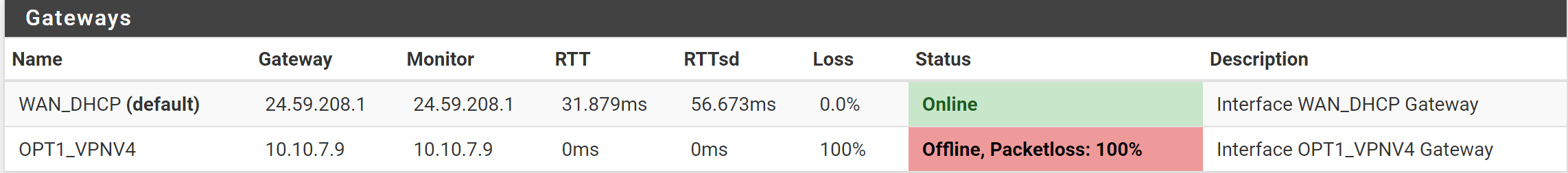

                    • W Offline
                      wgallt @viragomann
                      @viragomann
                      Ok. The Status -> Gateway shows Offline
                      The OpenVPN log shows Initialization Sequence Completed and I'm assigned and IP so not sure why that would be. So this is why the rule isn't hit being that I have the "Skip rules when gateway is down" option enabled.
                      • V Offline
                        viragomann @wgallt
                        @wgallt said in Gateway Change on Alias Not Applying:
                        So that's the problem.
                        Gateway offline doesn't necessarily mean that your VPN is not working, it tells you that to gateway does not respond to pings.
                        So you can either deactivate the gateway monitoring for the VPN gateway in System > Routing > Gateways, or if monitoring is desired, enter an alternative monitoring IP (a public IP which is responding to pings).
                        Also you can check System > Advanced > Miscellaneous > Skip rules when gateway is down if you don't want the rule to be omitted when the gateway is down.
