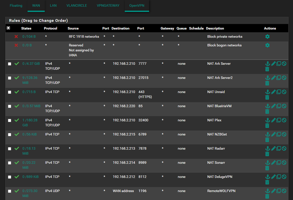

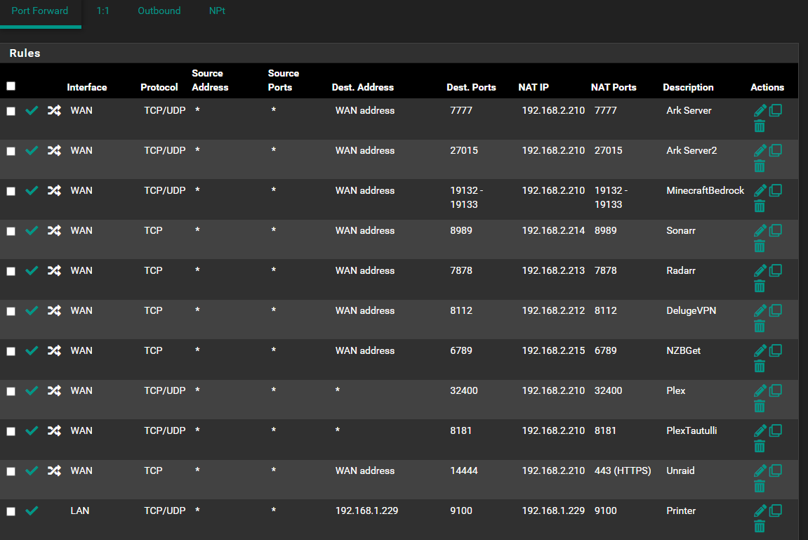

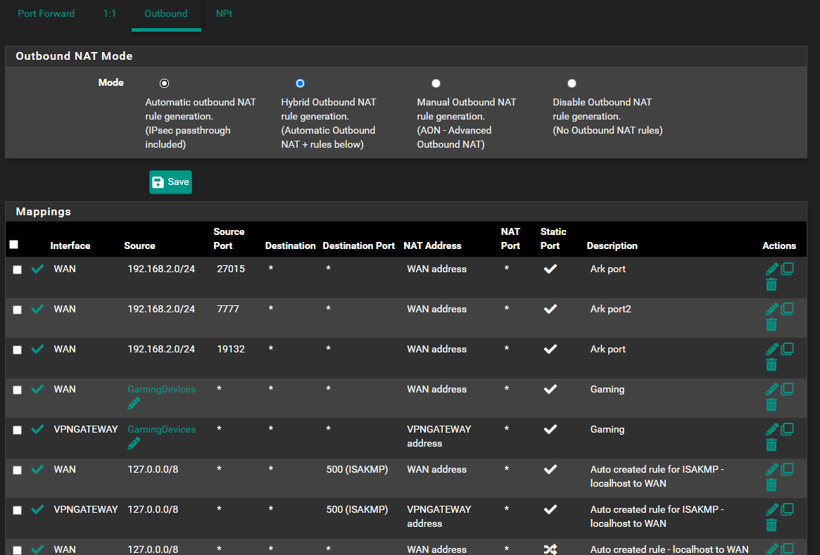

      When I create a simple port forwarding rule for an Ark: Survival Evolved server, allow it to create the associated interface rules, it somehow doesn't work. When I go and try to connect to the server from an external device it cannot connect to it. The logs wont show any sign of it being blocked. 20 hours of troubleshooting, scratching y had changing things, breaking other aspect and changing things back, and lastly resetting the firewall as a whole and restoring from back-up I found a solution.. I am able to create an outbound NAT rule for the specific port I need and it works fine.
      TLDR: I create a port forward and still cant connect, have plenty of others that work fine. If I create an outbound NAT rule as well it work. Why do I have to create an outbound NAT rule now for some select port forwards while other that have been there work? If I pause an existing port forwarding rule I can still ping that rule after clearing the states and rebuilding the rules as well. Doesn't make sense to me....
      Here's some associated screenshots.

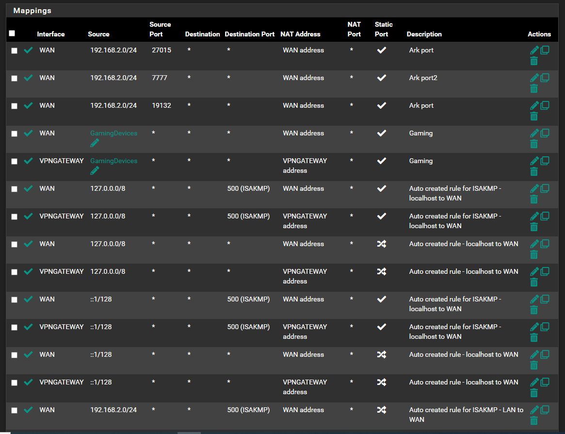

        Basically pfSense creates automatically the WAN outbound NAT rules in hybrid mode for all internal networks.
        However, maybe if you change your network settings, the outbound NAT gets not updatet.
        You screenshot doesn't show the automatically generated rules and I don't know your network settings, so I cannot verify. They should cover all your internal networks, the LAN and VLAN.

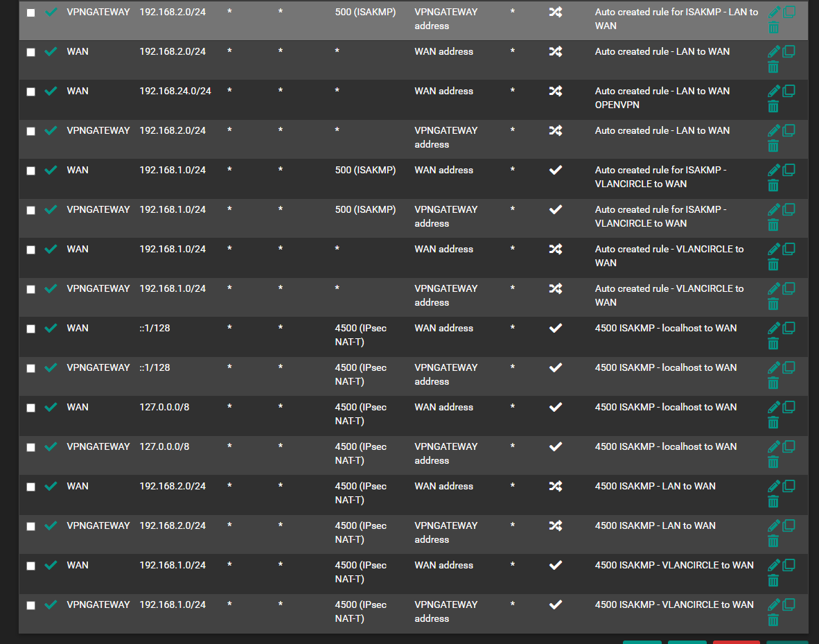

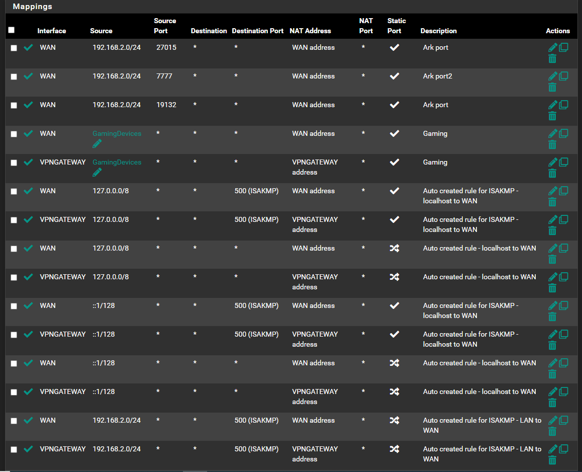

          @viragomann thanks for the reply. Its actually normally set on full manual mode with all of the existing rules not including the hybrid auto rules at the bottom. I changed it to hybrid to try and get the Ark server through and when it didn't work forgot to change it back to manual. These are all of my rules. I basically took all of the auto generated ones and made sure each on existed for the WAN and VPNGATEWAY.

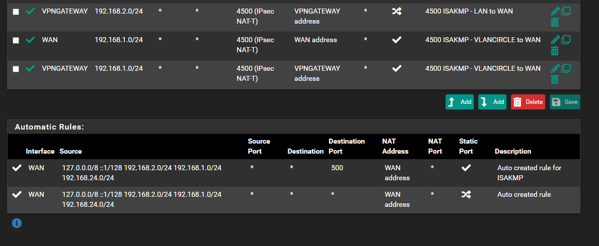

                Pretty many outbound NAT rules!
                These ones for dest port 4500 with no static port are useless at all. You may have to enable static port in these. However, they are only needed for IPSec and I assume that you don't run IPSec over OpenVPN.
                But that has nothing to do with your issue.

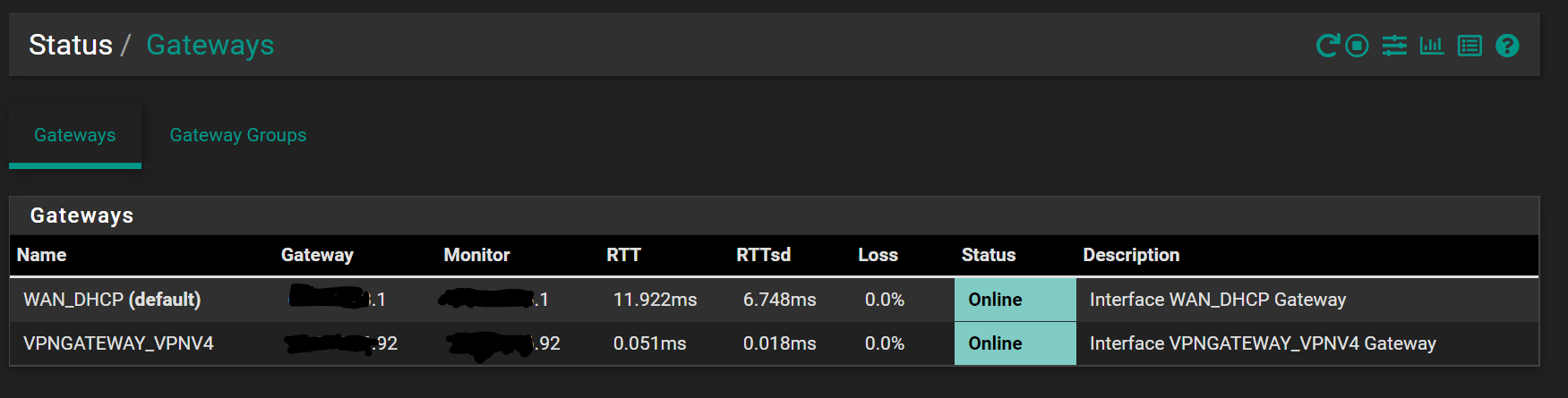

                What shows Status > Gateways?
                • W Offline
                  Wolfhunter1043 @viragomann
                  @viragomann Thank you, unfortunately most of those are foreign to me. I disabled the IPSec rules as I dont believe im using them then. If nothing breaks ill delete them. Here is my version and box info as well as gateway status.
                  I am on 2.6.0-DEVELOPMENT now however I was on the standard release software and tried the development one just to see if it helped.

                    If you access the Ark server from the Internet and your port forwardings and firewall rules are correct (don't know its requirements), you should succeed. That has nothing to do with outbound NAT.
                    Since you might have multiple internal network segments, are you able to acsess the server from another network?
