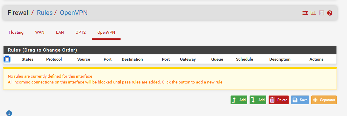

          OpenVPN interface has no rules.

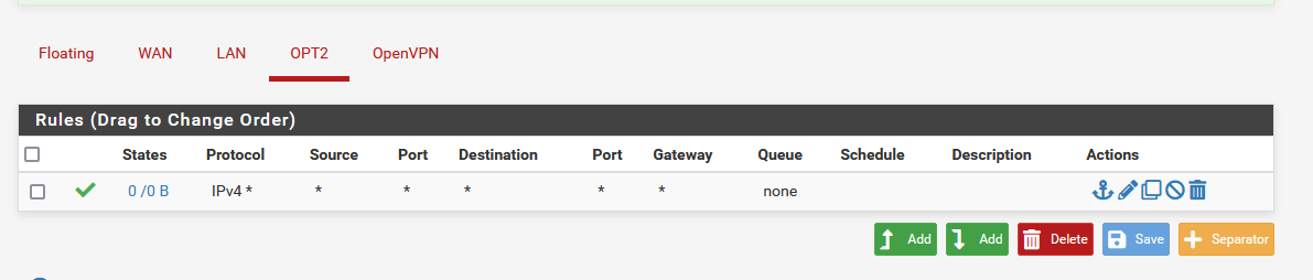

          The VPN is assigned to OPT2.

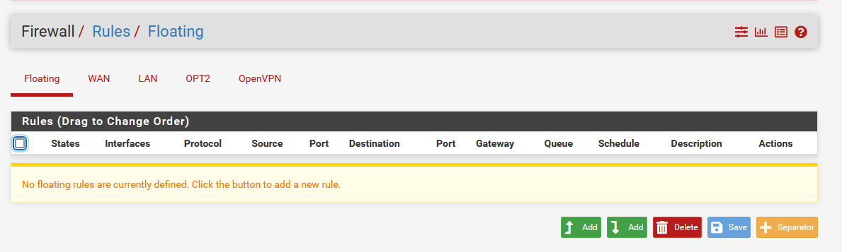

          There is also no floating rules set.
