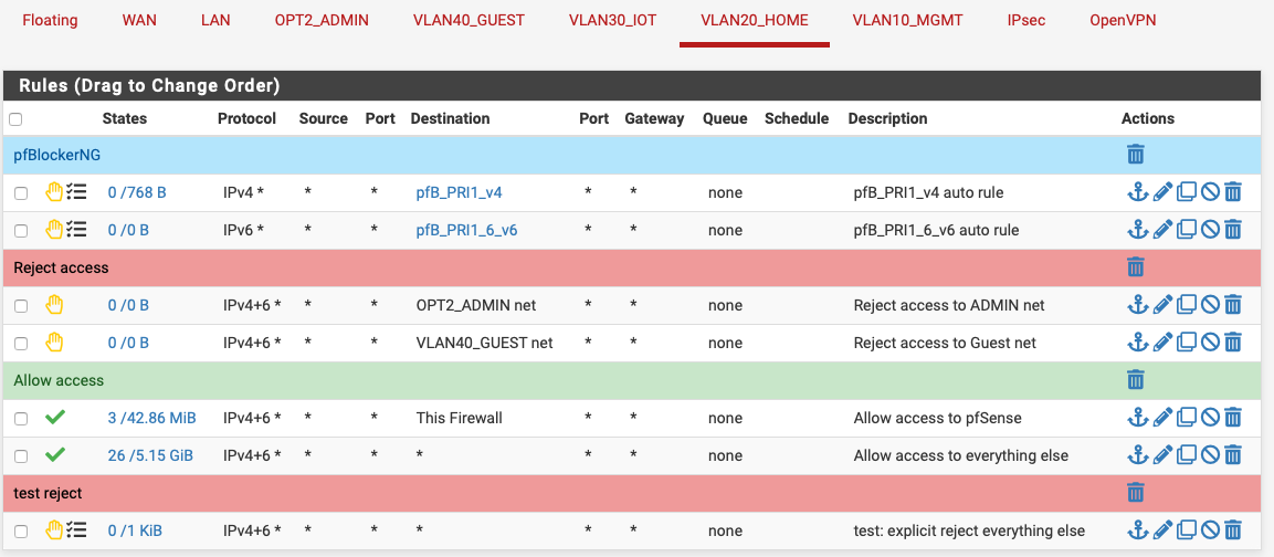

      My VLAN20 should have access to everything (for testing). However connections from only one client are caught by the default deny rule all the time. When debugging I also introduced a reject all after the allow all rule (which I would assume should never be reached). However als you can see, the reject all still gets triggered.
      Am I stupid? Did I do something obviously wrong? I can't figure this out myself...
      Ruleset:

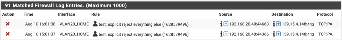

      Firewall log:
      The ruleset seams to be loaded (pfctl -sr excerpt):
      pass in quick on igb1.20 inet all flags S/SA keep state label "USER_RULE: Allow access to everything else"
      pass in quick on igb1.20 inet6 all flags S/SA keep state label "USER_RULE: Allow access to everything else"
      block return in log quick on igb1.20 inet all label "USER_RULE: test: explicit reject everything else"
      block return in log quick on igb1.20 inet6 all label "USER_RULE: test: explicit reject everything else"

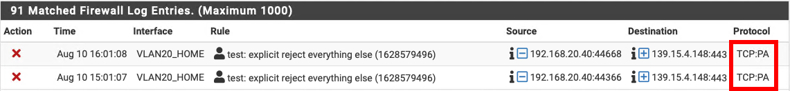

        Check the TCP flag. The packets are out of state and therefor not caught be the filter rule.

          Thanks! Honestly I completely ignored the TCP-Flags and until now I don't have an extended knowledge about them.
          Do you know any easy digestible source where I can read about that? I'm not really sure whether the PSH, ACK (that's what the PA means, right?) should not really happen (and the device has some faulty implementation) or if this is some kind of valid special use case.
          B johnpozJ V 3 Replies Last reply Reply Quote 0

              PA doesn't really mean anything other than just ack other than the PSH flag also set..

                            With the explicit reject rule it was pretty exactly one block an hour as TCP:PA. With the default deny rule it's a burst of the following sequence every hour: 1* TCP:PA, 2* TCP:FA, 8* TCP:FPA.
                            Won't worry anymore about these :) But definitely good to understand, what's causing the messages!
