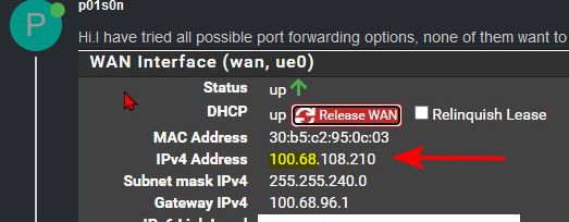

      Hi.I have tried all possible port forwarding options, none of them want to work. What am I doing wrong?

            this is WAN capture:
            00:47:43.792764 IP (tos 0x0, ttl 127, id 28641, offset 0, flags [DF], proto TCP (6), length 52)
            100.68.108.210.1080 > MyWhiteIPaddress.22: Flags [S], cksum 0xaf19 (correct), seq 896588029, win 64240, options [mss 1460,nop,wscale 8,nop,nop,sackOK], length 0

                      • johnpozJ Online
                        johnpoz LAYER 8 Global Moderator @p01s0n
                        @p01s0n Your behind a CGnat (carrier grade nat)
                        100.68.x.x is part of the cgnat range 100.64.0.0/10
                        100.64.0.0 - 100.127.255.255
                        So no your not going to get anything to work from the public net inbound to that IP.. Never, ever ever.. The only way it could work is your ISP forwarded traffic to that 100.x.x.x IP.. From some actual public IP.. CGnat is like what pfsense does for natting public to rfc1918, but for ISPs
                        https://en.wikipedia.org/wiki/Carrier-grade_NAT
                        You would have to get that info from your ISP - Its possible they might provide some ports that they allow inbound (they do the port forward)... But you would have to get the details of what specific ports they are sending you, and what public IP on the internet to send the traffic too..
                        Do you get an IPv6 address? I don't see one, link local isn't going to work.. Can you get IPv6 from them? Or you would have to get with an VPN services that allows inbound port forwarding via some ports. Or you would have to look into something like https://ngrok.com/ For a way to get unsolicited inbound traffic to you.
                        Or you could get a vps somewhere, create a vpn tunnel to it and send traffic to you via that..
                        Best option if your goal is inbound traffic is either get a actual public IP from your isp, maybe an extra charge per month, or switch isps that isn't using cgnat.
                        P 1 Reply Last reply Reply Quote 1
