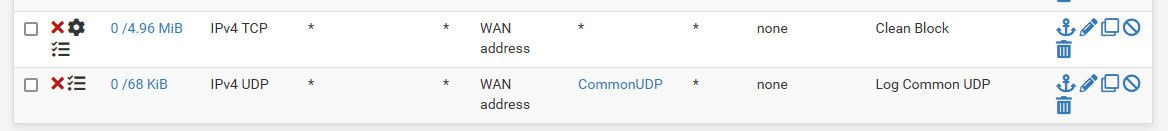

        johnpoz LAYER 8 Global Moderator @kingrazor
        There are hidden rules that allow dhcp when you enable dhcp server, and on wan for dhcp client, etc.
        No there would be no reason to allow for multicast on wan.. It sure not going to go anywhere - and pfsense. If the noise is bothering you in the log, you can just create a rule to block it and not log.
            I personally don't like seeing all the noise that default logging produces, so I turn off default logging and just put in my own rule that logs what I want to see which is common udp ports, and tcp traffic with syn set.
