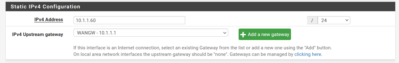

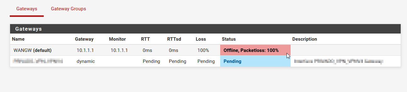

      Been working on this for a couple of months now. On and off. A bit lost as to what direction to go. Can't seem to get the Gateway to connect.
      Continue to get error dpinger error 64 in the logs, but those errors seem a bit general with no real direction.
      More than happy to provide logs or any other info to assist with pointing me in the right direction.

        • V Offline
          viragomann @DenverDesktopsSupport
          @denverdesktopssupport
          Not clear what you set here in the interface settings. If that's an OpenVPN interface you must not set a static IP in any case.
          This is configured by OpenVPN. In the interface settings use "none", just enable the interface.

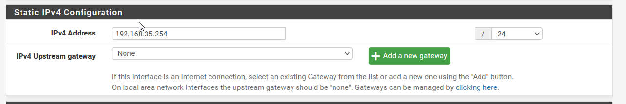

          • DenverDesktopsSupportD Offline
            DenverDesktopsSupport @viragomann
            @viragomann following this article. 192.168.35 is LAN
