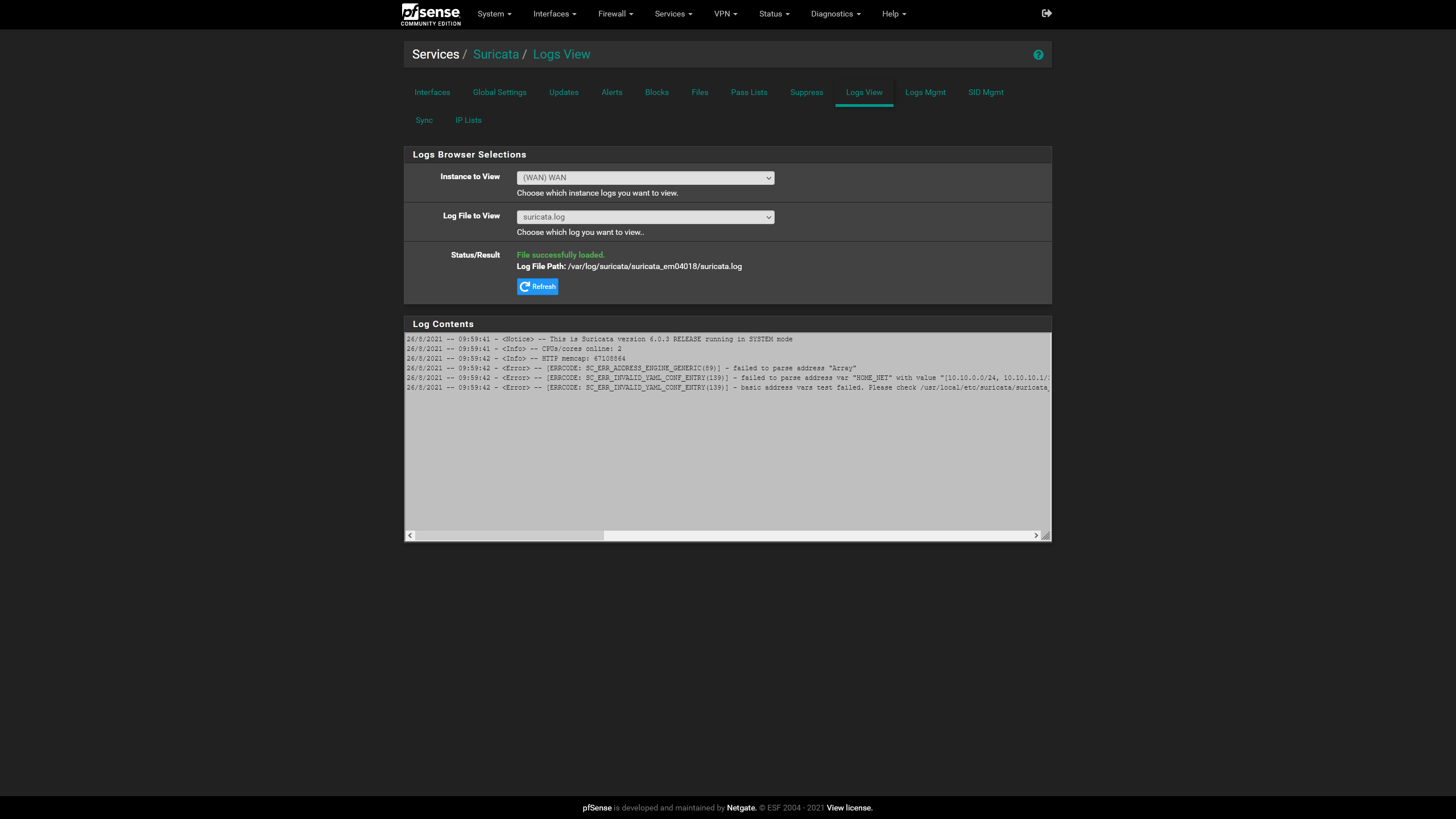

      Hello everyone,
      I have a strange problem with suricata that doesn't start automaticallly at PfSense boot.
      I have to wait a little to start it manually.
      In the log it says this :![alt text](Screenshot (3).png image url)
      I don't know what to do with it. I made a clean install of PfSense with a clean config but this error keeps coming
      In the suricata_XXXX_em0 's there's mention of this "array" in the HOME_NET and EXTERNAL_NET
      Thanks in advance.
      • bmeeksB Offline
        bmeeks
        My first guess is your physical interface assigned as the "WAN" in Suricata is not coming up fast enough. It's not in the "ready" state when Suricata asks pfSense for the IP information. Suricata expects that all interfaces are up and "online" when Suricata queries for their IP information when setting up the $HOME_NET variable. That empty array indicates to me the physical interface returned empty, and thus invalid, values when queried.
        Are you using some weird kind of NIC such as a USB connection or some kind of wi-fi dongle or something?

            The only time, in the past, I've seen problems such as yours in $HOME_NET is when a defined interface is not properly configured on the pfSense side. By that I mean it does not have an IP address assignment.
            I really need to see the entire error message. Your screenshot is cutting off the far right part of the message due to the horizontal scrollbar.
            The default behavior for constructing the $HOME_NET value is to include all locally-attached networks, the WAN public IP, any configured DNS servers, any VPNs and VIPs, and the default gateway. So look at the list of IP subnets and IP addresses shown in the error message and figure out what appears to be missing. In other words, what network address from the list I gave above is missing in the $HOME_NET message? That's likely the one causing the "Array" entry that Suricata is balking at.

                suricata.log after failure to start at boot
                28/8/2021 -- 16:16:13 - <Notice> -- This is Suricata version 6.0.3 RELEASE running in SYSTEM mode
                28/8/2021 -- 16:16:13 - <Info> -- CPUs/cores online: 4
                28/8/2021 -- 16:16:13 - <Info> -- HTTP memcap: 67108864
                28/8/2021 -- 16:16:13 - <Error> -- [ERRCODE: SC_ERR_ADDRESS_ENGINE_GENERIC(89)] - failed to parse address "Array"
                28/8/2021 -- 16:16:13 - <Error> -- [ERRCODE: SC_ERR_INVALID_YAML_CONF_ENTRY(139)] - failed to parse address var "HOME_NET" with value "[10.10.0.0/24, 10.10.10.1/32, 10.10.20.0/24, 10.10.30.0/24, 127.0.0.1/32, 192.168.1.14/32, 192.168.1.254/32, 193.19.108.2/32, 194.242.2.2/32, ::1/128, Array, fe80::a236:9fff:fe18:6f7c/128, fe80::a236:9fff:fe18:6f7d/128, fe80::a236:9fff:fe18:6f7e/128, fe80::a236:9fff:fe18:6f7f/128]". Please check its syntax
                28/8/2021 -- 16:16:13 - <Error> -- [ERRCODE: SC_ERR_INVALID_YAML_CONF_ENTRY(139)] - basic address vars test failed. Please check /usr/local/etc/suricata/suricata_10842_igb0/suricata.yaml for errors
                HOME_NET after manual start
                HOME_NET: "[10.10.0.0/24, 10.10.10.1/32, 10.10.20.0/24, 10.10.30.0/24, 127.0.0.1/32, 192.168.1.14/32, 192.168.1.254/32, 193.19.108.2/32, 194.242.2.2/32, ::1/128, fe80::a236:9fff:fe18:6f7c/128, fe80::a236:9fff:fe18:6f7d/128, fe80::a236:9fff:fe18:6f7e/128, fe80::a236:9fff:fe18:6f7f/128]"
                pfSense 2.5.2 or 2.6.0-dev.
