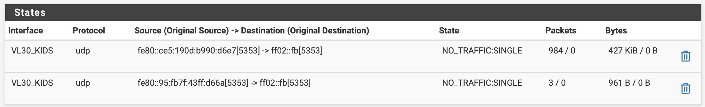

                  I'm still confused though. Here's what I see for the link local addresses on my VL30_KIDS interface:
                  	inet6 fe80::208:a2ff:fe0d:153f%lagg0.30 prefixlen 64 scopeid 0xe
                  	inet6 fe80::1:1%lagg0.30 prefixlen 64 scopeid 0xe
                  However, when I see the current states on the interface, it shows these as the sources and destinations:
                  fe80::ce5:190d:b990:d6e7[5353] -> ff02::fb[5353]
                  fe80::1c5f:ab8a:c0d:d49[5353] -> ff02::fb[5353]
                  Those don't match the address of the link local address on my interface, so I'm confused on where those are coming from then?

                                  To be honest does he really even need IPv6 mdns resolution.. IPv4 would normally work in your typical users setup without having to do any special rules.. Because the default rules would allow for the source net, and the dest via any..
                                  Where you run into problems with source net for link-local, is client A is going to be in a different prefix anyway from client B - even if they are in the same L2..
                                  Here is client of mine
                                  inet6 fe80::3bc8:c970:a732:ac17  prefixlen 64  scopeid 0x20<link>
                                  That is connected to pfsense interface but it has
                                  inet6 fe80::208:a2ff:fe0c:e621%igb3 prefixlen 64 scopeid 0x4
                                  Now if the client sent the mdns query from its GUA address - you don't have this problem.. But this whole discovery protocol is only meant for L2 anyway.. So other than a firewall/router you wouldn't normally run into the problems say client finding the printer..
                                  I would think a "note" on the package on what rules you "might" want to add or edit if using avahi would be a way better idea then auto creation of rules..
