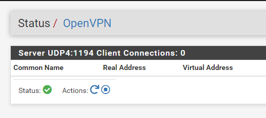

        Idiot maneuver not seeing this initially:
        Here's my server status. Looks okay?
        Firewall logs? Nothing there when I try and connect to my WAN address on the openVPN port.
        OpenVPN logs? No errors. I restarted the OpenVPN service just now, looks OK.
        I have to be missing something really obvious but.. seems like I've covered all the bases from the documentation.

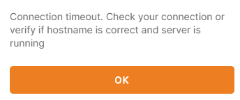

          • B Offline
            brunoforestier @viragomann
            • V Offline
              viragomann @brunoforestier
              @brunoforestier
              This basically indicates that the client doesn't get a respond from the server.

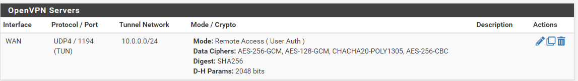

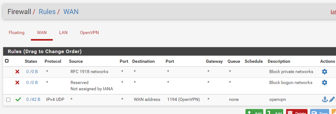

              • B Offline
                My WAN IP is DHCP from my CenturyLink ISP. I don't see anything online that indicates I shouldn't be able to connect to a VPN server hosted by one of these addresses.
                • V Offline
                  @brunoforestier said in First time OpenVPN server:
                  You should be able to assess if it's a private or CGN address.
                  The rule looks well.
                  You can use Diagnostic > Packet Capture to verify if OpenVPN packets arrive on the WAN interface. Select WAN interface, set the port filter to 1194, start the capture and trigger a connection.
                  The port scanner you mentioned above seems not be capable to send UDP packets. Consequently it will show the port as closed, since the rule allows only UDP.
                  But you should be able to see the packets in the capture.
