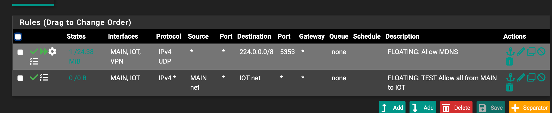

@johnpoz on my floating rule the direction is set to any.
By the way, same problem the other way round, I have an Apple HomePod (192.168.12.145) on IOT and I am not able to "discover" it with my phone on MAIN. Pcap does not show any SSDP from the HomePod just MDNS.
I've created a test floating rule to allow all from MAIN to IOT. However, I do already have explicit default deny rules on all interfaces with logging enabled and cannot see any blocked firewall traffic from the Denon (192.168.11.20). Still no luck.

This is how it should be set.. Set it like this - and set your firewall rule to 224.0.0.251

@johnpoz Ok, I've adjusted my settings to match yours including the floating FW rule. I too am on v 2.2. Not sure what else could be the issue unless something funny going on with the ubiquiti AP or Netgear switch :(
