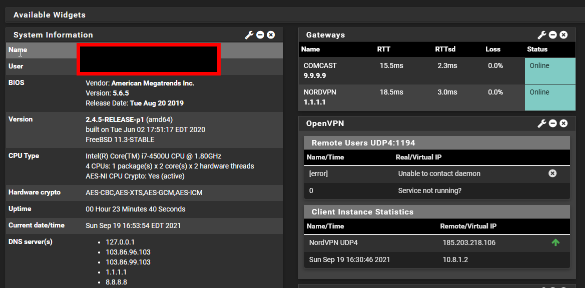

      My PFSense's box specs:
      2021-09-19 16_53_57-MLC-PFSENSE.localdomain - Status_ Dashboard and 1 more page - Personal - Microso.png

      What could be causing the speeds to be so slow through the PFSense? What could I adjust in the OpenVPN client settings to improve the speeds?
