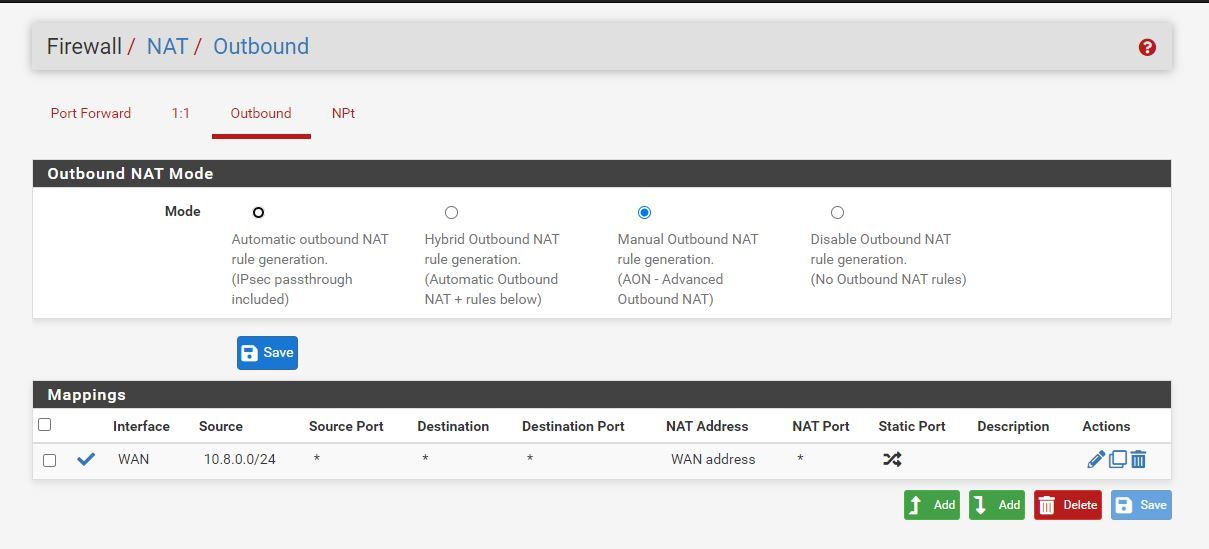

      So your client connects successfully and routes all upstream traffic to the VPN server.
      The outbound NAT shown in your screenshot is necessary at all, but use the hybrid mode so that automatically generated rules are still active.
      So what's the problem now?
      If you are not able to access the internet ensure that DNS resolution is working on the client.
        i did it but not helped
