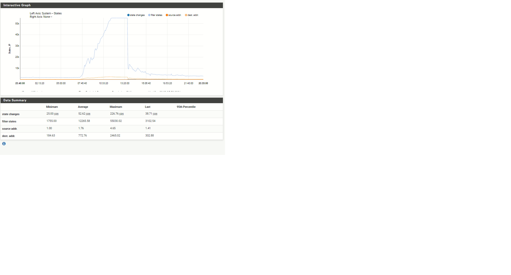

      Hello! I ask you to help me. A few days ago there was a problem, it repeats every day at about the same time. I made a screenshot of the monitoring, what to do next, there is not enough knowledge. I ask you to help me.

        The message says that your pfsense State-Limit has been reached. You can increase the limit under
        System > Advanced > Firewall & NAT
        Firewall Maximum States
        This will mitigate the problem that the limit is reached. But i suspect that this might not be enough.
        Moreover you should check what causes theses high states (e.g. misconfiguration, scan to somewhere, cron-job). As it is about the same time you should dump either state-table using
        pfctl -ss > filename
        and analyse. If that does not reveal it use tcpdump to see what is happening.

          @fwcheck said in [zone: pf states] PF states limit reached:
          Exactly - if happens around the same time everyday.. Do you have some sort of scan taking off? That seems like a high amount of destination addresses..
          Sure likes a scan of some sort to me.. You have a really low number of source IPs.. So I take it not a lot of clients?
          Where are all the states too? or from?
