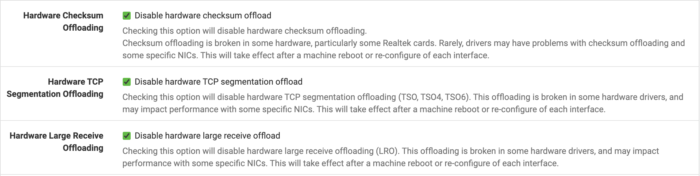

      1. Snort Interfaces > WAN > IDS/IPS mode Inline - after that I got popup that I should enable Hardware checksum offload, Hardware TCP Segmentation Offloading and Hardware Large Receive Offloading.
      2. I did it in Advanced > Networking and enable these three settings

              When using either of the two IDS/IPS packages, whether with Inline IPS Mode or with Legacy Blocking Mode, you should leave all hardware offloads disabled. With today's highspeed CPUs, there is very little impact from letting the software stack handle those chores.
              The problem with hardware offloading being enabled is that the NIC then sends "weird" and somewhat non-standard packets through. And those weird packets can trip up and fool the IDS/IPS. Some forms of hardware offloading can also result in packets completely bypassing the IDS/IPS engine altogether, thus those packets are not even inspected by the engine.
