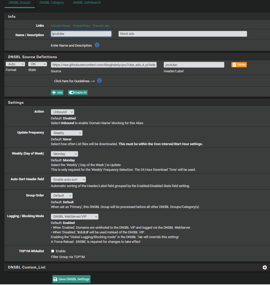

    • w0wW Offline
      w0w
      DNSBL->DNSBL Groups create NEW group
      Use https://raw.githubusercontent.com/kboghdady/youTube_ads_4_pi-hole/master/youtubelist.txt
      as source, got it from https://github.com/kboghdady/youTube_ads_4_pi-hole
      Reload pfBlockerNG, try some browser and open Youtube.
      P.S. Works fine on the different browsers but not on the android Youtube app.
      Edited, URL fixed, thanks provels
      provelsP 1 Reply Last reply Reply Quote 2
