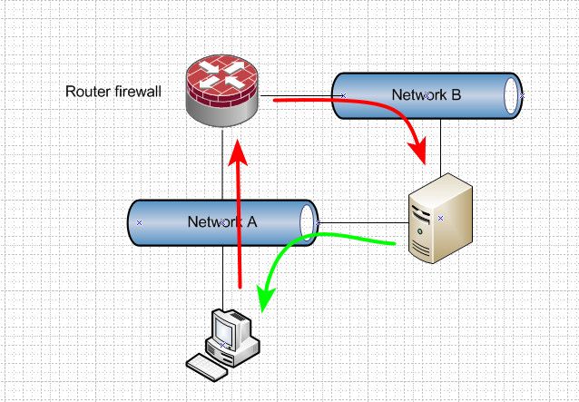

          johnpoz LAYER 8 Global Moderator @WhiteTiger-IT
          @whitetiger-it said in With all the Server NICs active, I lose the connection in LAN:
          I have a server with 3 NICs, connected to 3 switches. There are no VLANs.
          After about a minute I lose the connection.
          I try to imagine that the problem is due to an incorrect configuration of pfSense
          What screams out to me with a device connected to multiple networks is Asymmetrical traffic..
          Multi-homing a device almost always leads to asymmetrical traffic..
          So you have some client in network A, and wanting to talk to IP in network B.. This is routed through pfsense. State is created when pfsense see the syn. But device in B says - oh I am on that network, I will just send the syn,ack directly to that IP.
          At some point pfsense is going to say.. I see no answers back from this state I created - going to close it via timeout. Now your connection drops.
          Multi-homing devices almost always a bad idea, and unless you fully understand the complexity and security issues this brings.. You shouldn't be doing it.. The funny thing is - if you do understand them, you would know how bad of an idea it is - and not do it ;)

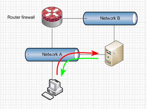

          If you are going to start a conversation with a multi-homed device. When you want to talk to it from a device that is in one of its multiple networks, then use the devices IP in that same network to talk to it.
          Vs using network B ip to talk to the device, use its network A address from device in network A - now you never run into asymmetrical problem with a stateful firewall/router

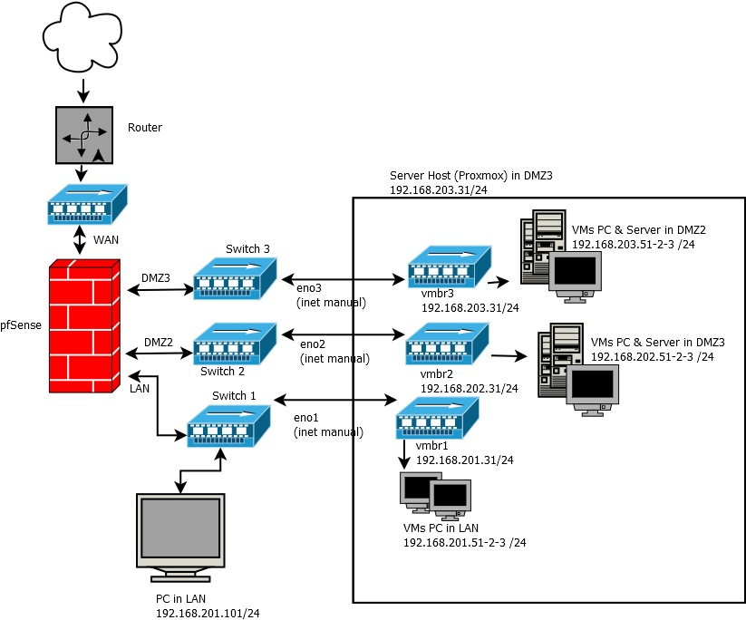

                        This is the simplified representation of the network I am implementing.
                        A physical PC in the LAN must be able to connect to a Host Proxmox server in DMZ3.
                        Inside this server there are 3 virtual networks corresponding to the LAN, DMZ2 and DMZ3.
                        Obviously, the PCs in the LAN (whether physical or virtual) must be able to connect to the PCs and Servers in the DMZ2 and DMZ3.
                        Instead:
                        • the virtual PCs present in the DMZ2 must be able to connect only to the servers of the DMZ2.
                        • The virtual PCs present in the DMZ3 must be able to connect only to the servers of the DMZ3.
